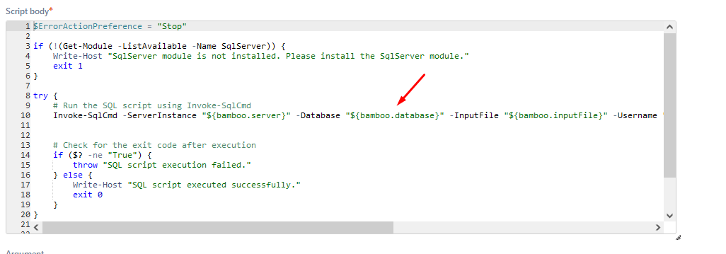

I have a pipeline that takes a SQL script and invokes it into a database via powershell.

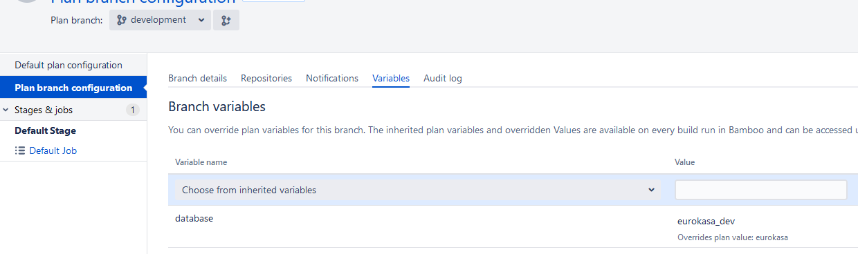

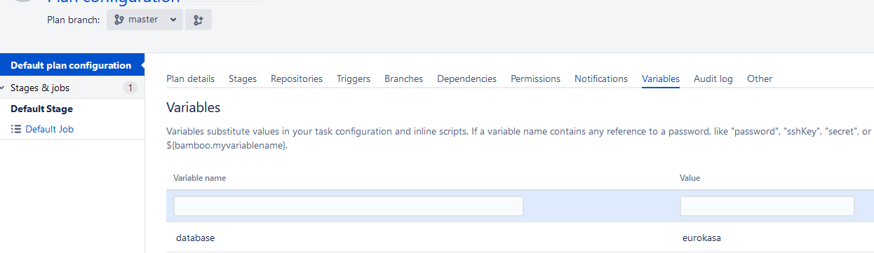

I have a variable "database", which is "value1" for the main branch (master) and "value2" which I have overridden for branch "development.
The problem I am having: when running development branch build I can see in logs that Bamboo substitutes the database variable for the one set in master branch. What I mean is, it takes "value1", but not "value2". Does anybody have an idea where the problem might be?

I didn't realise it at first, but this solution works only for default branches (in my case development and master).
What I didn't notice is that it doesn't work when making pull requests.
Since Bamboo creates a new branch for each new pull request, that new branch does not have any default variable values, so it takes the values from the default repository branch, which in this case is master, and default database variable value is "eurokasa".
A little powershell hacking did the trick, but it would be nice to have a better in-house solution.
My solution: check if pull request key exists, if yes - check target branch and set database variable accordingly.
If not - use default branch variable.
