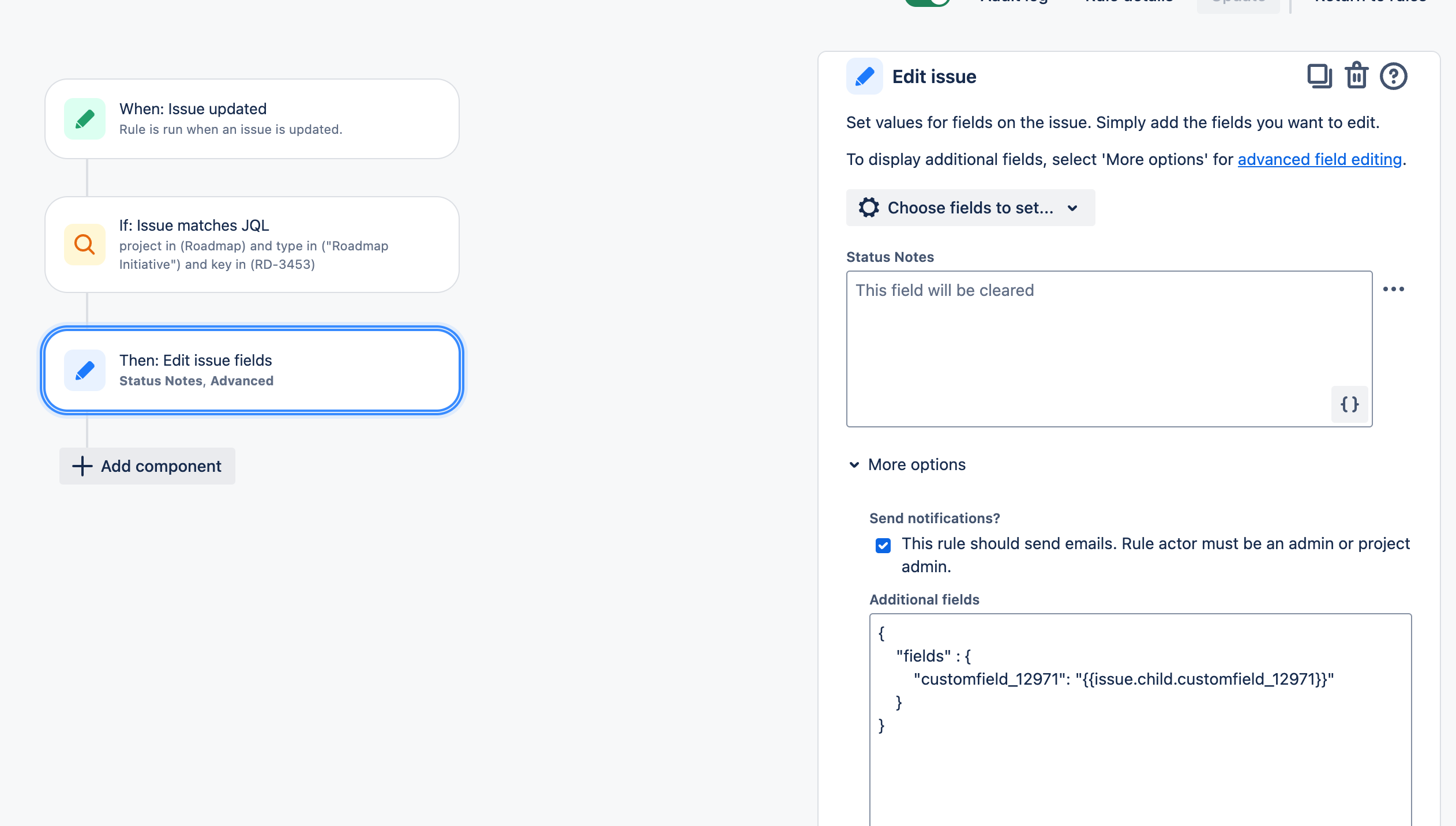

Im hoping to get some help. We have a custom field (customfield_12971) that is used at two different ticket hierarchies. Initiative and Feature Level. We leverage this field for statuses (in a string format). What I want to do is roll all the child inputs of customfield_12971 into a singular output in the parent customfield_12971.
So essentially if there were 3 child tickets with statuses like the below:
Child 1 (customfield_12971) is:
  • Status is blah blah
Child 2 (customfield_12971) is:
  • Status is ABC
Child 3 (customfield_12971) is:
  • Status is 123
Then the parent (customfield_12971) would be:
  • Status is ABC
  • Status is 123
Note: this would be an automated push (happening weekly) so Im not too worried about syncing it up as a singular child ticket is updated (although that would be ideal)
I have a rule set up and it says it is successful but the info isnt populating in the parent at all. I suspect its because there are multiple children, any workarounds? Thanks in advance!

Travis Hill
December 17, 2024
@Bill Sheboy Ive been messing with your recommendations and I think Im sort of close to getting whats need using the lookup issues functionality. Now im just getting this error
Its obviously stemming from something Im doing in the rule that I cant quite put my finger on. Any thoughts?

Bill Sheboy
December 18, 2024
Hi, @Travis Hill
The JSON you show is missing a closing curly-bracket: they need to be paired up to match.
And, that is assuming that structure works for the field type.  When the field is text, the JSON would be this:
"fields": {
"customfield_12971": "{{customval}}"
When the field is another type, please look here to learn the correct syntax: https://support.atlassian.com/cloud-automation/docs/advanced-field-editing-using-json/
