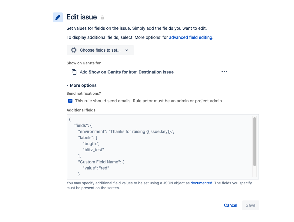

2. How can I populate the target multi-select field - it doesn't appear to be available. I've found some community posts that indicate the fix is to use the More Options JSON but I can't find any training for coding novices on what to actually put in it.

Yes you can achieve this using JSON, something like this:
"update": {
"your_custom_multiselect_field_name": [
"set": [{"value": "{{issue.project.key}}"}]
For more details and usage with examples, you can refer here.

You can set value like:
"customfield_11448" : [ { "value": "option1" }, { "value": "option2" } ]
or
"customfield_11448" : [ { "id": 10112 }, { "id": 10115 } ]
So either use value or id not "{{project.key}}" inside set .
