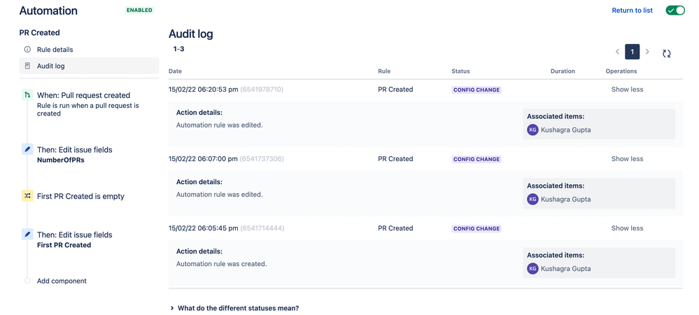

I am trying to use PR Created Trigger under Dev Ops Rule. But it's not getting triggered.
Though all gitHub data(commit , PR , branches ) is shown correctly in development section of the issue.
Please help.

Could you please add screenshots of your automation rule, an audit log and the issue where git-entities are connected and should trigger the rule?
BestStefan
Hello @Stefan Salzl , Thanks for welcoming me to the community.Below is the screenshot of the rule.
Below is the screenshot that GitHub is connected to Jira and we can see development info.
Below is the screenshot of the audit log. This rule is not getting triggered.
Hope it helps.

I even tried creating another rule , adding a comment once branch is created.
That's also not working.
