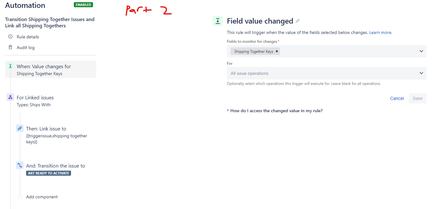

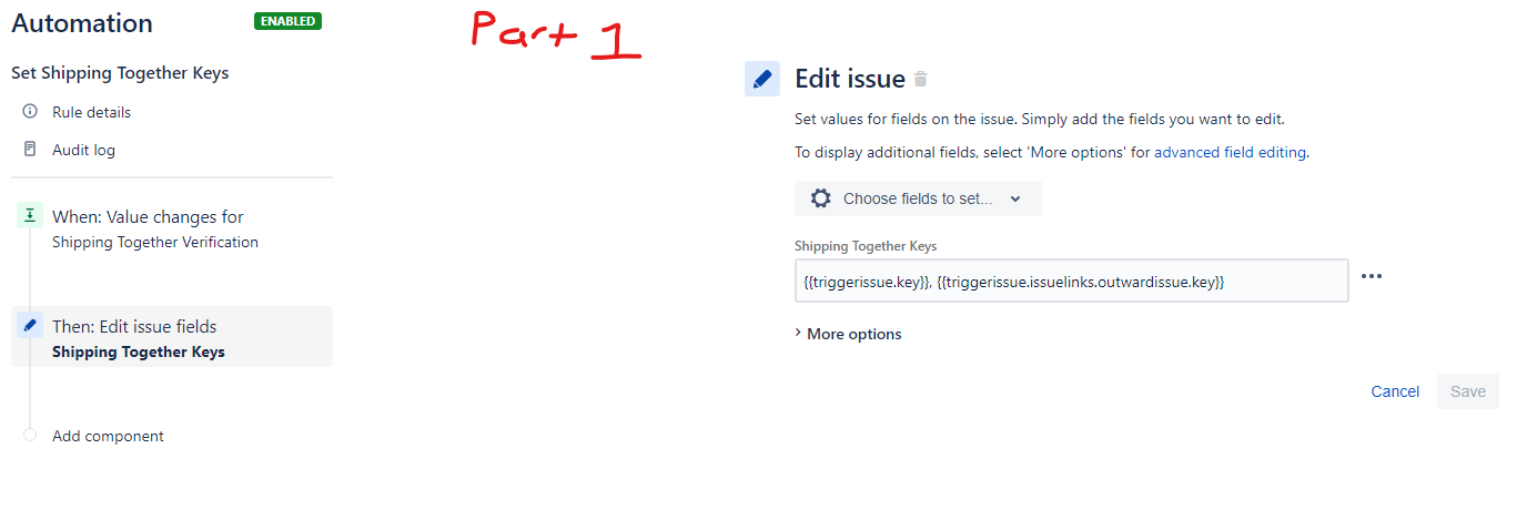

I am trying to come up with a way to accomplish the following using Automation for Jira:
- Issue is linked to multiple issues. (IE: Issue A links to Issue B, Issue C, and Issue D using as a Ships With Link)
- Issues that were linked to the single issue also link to the other issues as well. (IE: Issue B links to Issue C and Issue D using a Ships With Link. Issue C links to Issue B and Issue D using a Ships With Link. Issue D links to Issue B and Issue C using a Ships With Link.)
Currently I have come up with a way that when a issue is linked with the Ships With Link that a custom field will populate with all of the Issue Keys (the Issue Key of the Trigger Issue as well as all of the Linked Issues). I am then linking the other issues to all of the Issues Keys in the Custom Field.

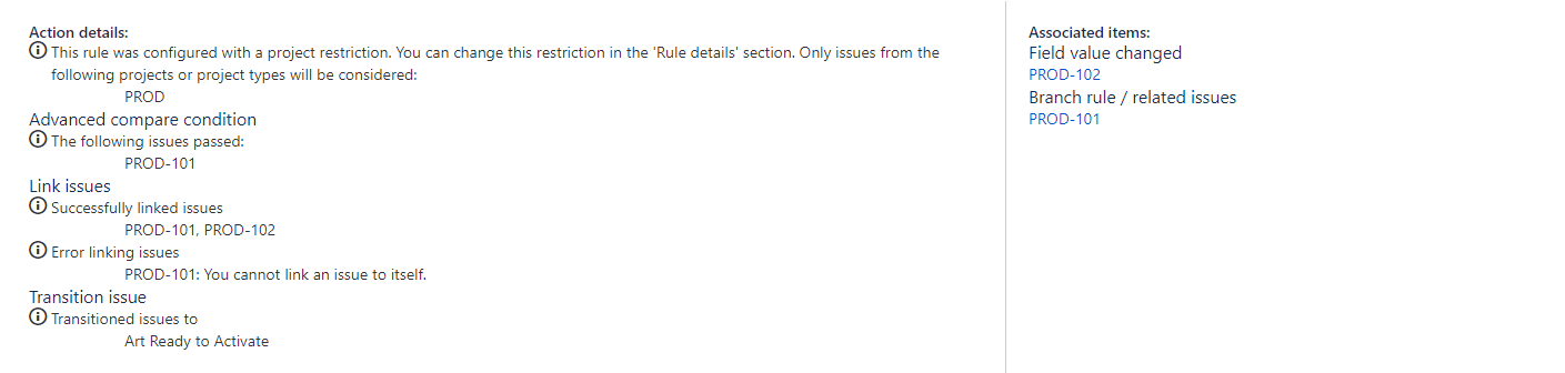

The problem I am running into now, is that the automation does link the issues as it should, but, it does always throw the error of "You cannot link an issue to itself." (because the Issue Key for the Issue also resides in the list on the Custom Field).
My question is, is there a easier method that anyone has accomplished linking all the issues back to one another? Or, is there a way to ignore the error of "You cannot link an issue to itself." so that I will still receive emails when a rule fails after a success?
Attached are screenshots of the rules and error log
