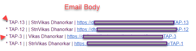

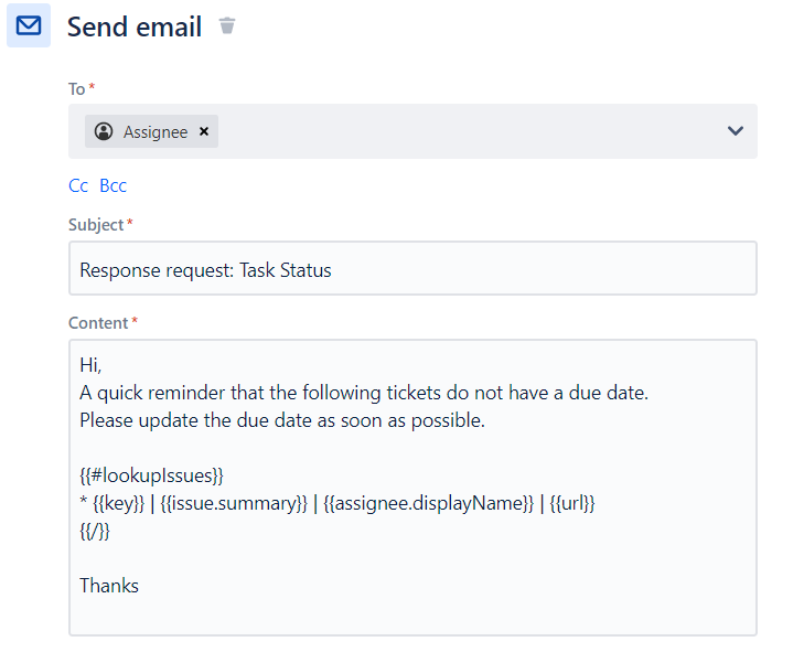

Is there a way to send one email to one assignee with email body containing only assignee's issue
vdhanorkar
July 27, 2022
I have created one automation rule and I am trying to send a list of issues to the individual assignee through a single email but could not do that. Users are receiving multiple emails also they are receiving other's tasks details in the email body(See the second screenshot).
Is there a way where I can send a list of issues to each individual through a single email?

It would help if you can screenshot your entire rule.
If you are using a JQL condition then you need to take the email action *outside* of that condition because it's executing for *every* issue it finds.
Not sure why it's showing other assignee's issue unless there's a problem with your JQL.
So yeah, seeing the whole rule would let us better help you.
Darryl Lee
July 27, 2022
Sorry, I hadn't had enough coffee this morning. :-}
Upon re-reading your question, I'm guessing that you are doing a lookup of issues where Due Date IS EMPTY.
So yeah, I think the problem is that unless you constrain the query to a single assignee (and then you'd have to create rules for every assignee), then it's going to (apparently) mail every assignee the list of everyone's issues.
vdhanorkar
July 28, 2022
@Darryl Lee Thanks for looking into this, here is the screenshot as you requested.Rule.png

Darryl Lee
July 28, 2022
Yeah, I don't think they should've closed AUT-1975 as a duplicate because while AUT-684, AUT-285, and AUT-105 are related they are not the same.
So yes, as I suspected, your query will always return a list with multiple assignees, and so there's no mechanism to iterate through each assignee and send a list with only their issues.
Hum, if you could iterate through the list of assignees, you could probably use filters to do something like:
{{#allassignees}}
{{#lookupissues}}
{{#if(assignee.accountId == allassignees.this.accountId)}}
* {{key}} | {{summary}} | {{assignee.displayName}} | {{url}}
But the problem is 1) I don't know how to get that list of assignees out of Jira, 2) I don't think you can have nested lists in Automation. :-/
Darryl Lee
July 28, 2022
Oh man! I'm getting close! Got the list of assignees and can iterate through it with Advanced branching, accessing {{lookupIssues.assignee.distinct}} like so (this is the "For each" section that shows up in the full rule at the bottom:
But the problem then is my "filter" can't access the thisassignee variable within {{#lookupissues}} for the email body. I unsuccessfully tried:
{{#lookupIssues}}
{{#if(assignee.accountId == thisassignee.accountId)}}* {{key}} | {{summary}} | {{assignee.displayName}} | {{url}}{{/}}
(which gave each assignee a blank email)
and
{{#lookupIssues}}
{{#if(assignee.accountId == {{thisassignee.accountId}})}}* {{key}} | {{summary}} | {{assignee.displayName}} | {{url}}{{/}}
which failed with:
Error rendering smart-values when executing this rule:
Here's what I'm working with. Any thoughts, @Bill Sheboy?
Darryl Lee
July 28, 2022
Ah, think you solved this previously, @Bill Sheboy by adding another JQL query for each assignee. Clever. https://community.atlassian.com/t5/Jira-questions/Smart-Value-Filtering-Comparing-Two-Lists/qaq-p/1959275
For option #3, you could use lookup issues and advanced branching to then notify the people...or send yourself n-emails (one for each person).  Here is an example rule to do this:
Let me give that a hack.
Bill Sheboy
July 28, 2022
Yes, and...
I believe the requestor asked the same question in this other thread, where I also answered: https://community.atlassian.com/t5/Automation-questions/Re-Re-1-Notification-per-assignee-via-Automation-on-Jira/qaq-p/2092384/comment-id/4502#M4502
Like • vdhanorkar likes this
Darryl Lee
July 28, 2022
Success!
Full rule: Screen Shot 2022-07-28 at 3.01.18 PM.png
And details on the new second Lookup:Screen Shot 2022-07-28 at 3.01.08 PM.png
So there you have it. BTW, I corrected your original mail body @vdhanorkar because you had {{issue.summary}} when you just need {{summary}}.
Like • Bill Sheboy likes this
vdhanorkar
July 29, 2022
Thanks @Darryl Lee , it works to me, thanks for looking in to it.
