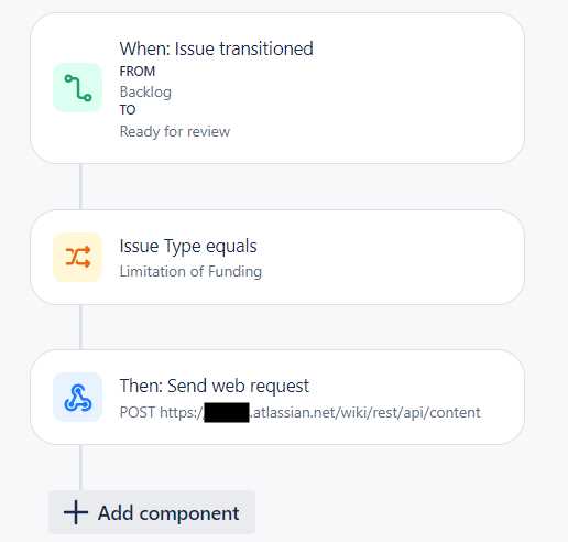

General View of Rule:
Very basic rule. When issue moves, if it's a certain type please create a page. All information is filler information for now.

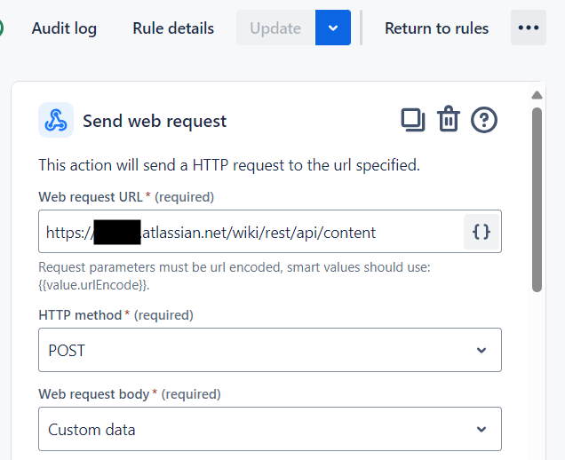

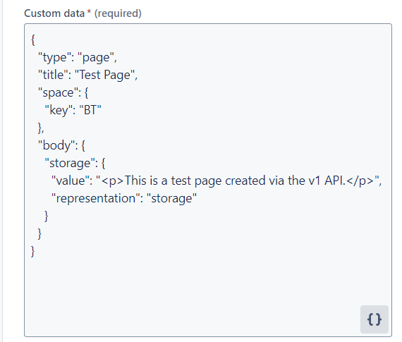

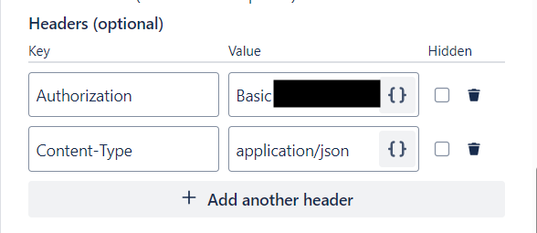

Specifics of "Send web request:"
Below are screenshots of the action.
I do know the URL posted in the screenshot is going to be deprecated in 2025. When the rule is actived, this URL leads to this error:
Unable to publish the web request - received HTTP status response:
403
Error found in the HTTP body response:
{"message":"current user not permitted to use Confluence","statusCode":403}
When I use the URL for Confluence Rest API 2.0:
https://domain.atlassian.net/wiki/rest/api/v2/pages
I receive this error:
404
{"message":"null for uri" https://domain.atlassian.net/wiki/rest/api/pages/","statusCode":404

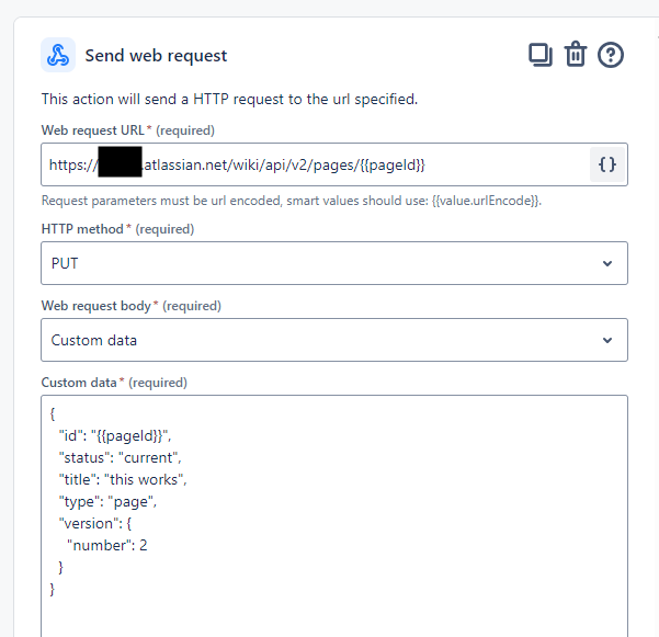

In the beneath images, I have:
  1. Added "Create Page" action
  2. Added a delay
  3. Logged the created PageID as a variable
  4. Added a "Log Action" to confirm the correct page ID, which it is.
The information I'm attempting to update is quite simple for now. I just want to change the title of the page, and increase the version increment by 1.

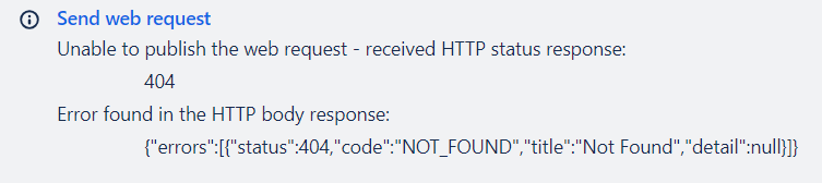

I now get a different Error 404.
I took the same payload information and put it into VSCode in Python format, ran the script, and it updated the already existing page that was just created by the first part of my automation in Jira. So, I've confirmed the endpoint, the page id, and the payload reads in Python and are correct.
Would you be able to explain why it's not working in the Jira Automation Web Request action? I feel like I'm missing something simple.
Updated Automation Flow:
Updated Web Request Info:
New Error Code:

As long as the account you are using in the Authorization header has view and update permissions for the space then I can't explain why the web request action in the automation rule gets back a 404 error when making the same call from your script works fine.
I do see that the Update Page API requires body in the request body but I don't see that in your JSON. I would expect that a missing element in the request body would return an HTTP 400 but I've seen some odd response codes from Atlassian before. I find it really odd that body is required because if you are just changing the page title (for example) why should you have to send the existing page body in the request?
I suppose it might be worth making the body a smart value in the automation rule then use that to pass in the request body of the web request action to see if that helps? If you aren't passing that in your Python code then that element may not actually be required despite what the documentation says.

Thanks for the prompt reply. Maybe my authentication is off in the automation rule while the script is correct, so I'll check that out. I'll also add the body. It worked without declaring a string for an updated body it in the script, but maybe I did something wrong. It's typically user-error for me haha.
