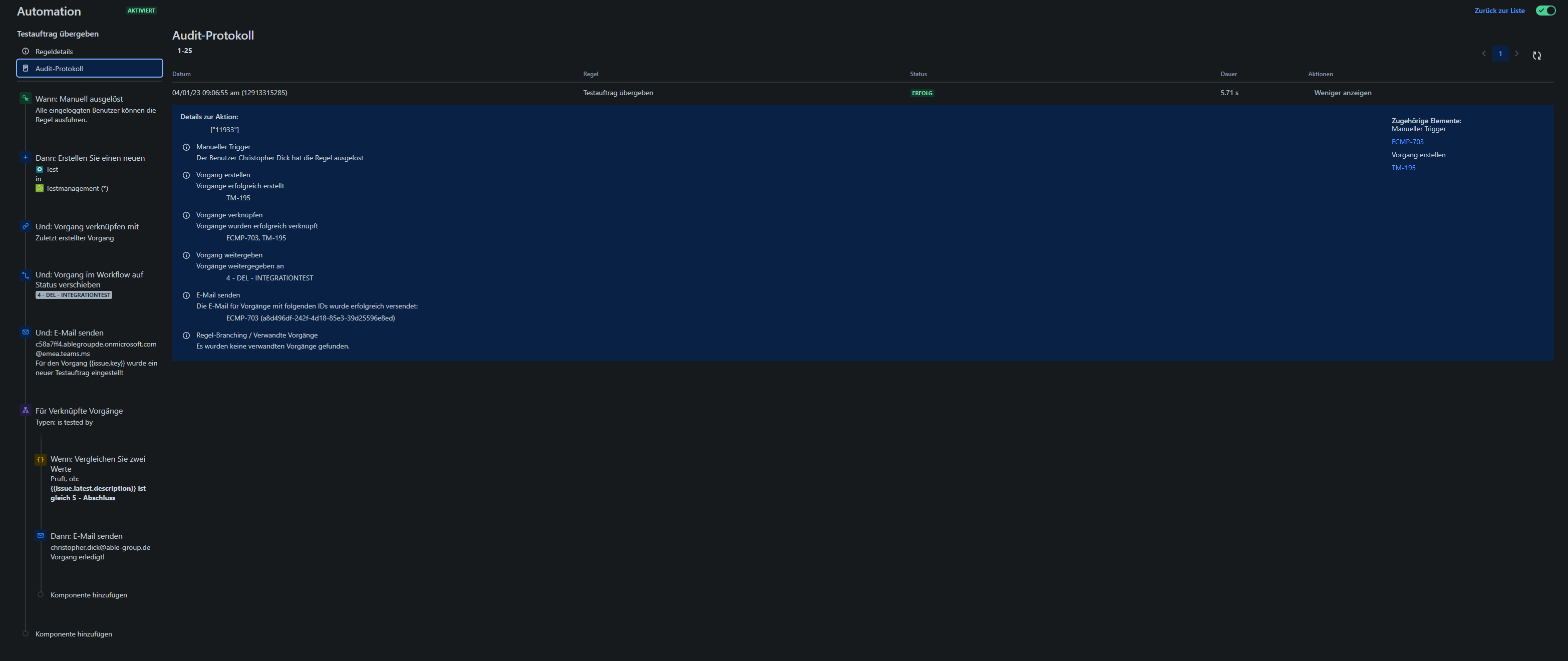

Hi there,
The attached screenshot shows an automation rule for the following process:
Unfortunately, the automation is successful only up to and including step 5. The status labels are different in both projects.
I am looking forward to your tips and ideas.
Many greetings,
Christopher
Screenshot
Hi @Christopher Dick ,
Welcome to the community!
If I understand correctly, you want to keep track of the status of the newly created task and act when it is done.
However, the trigger of this particular rule was the manual action. It can do stuff and act on conditions as they are right now, but then the rule will simply stop.
If you want to act when an issue closes, this is a different trigger you need to monitor, so you will need to create a new rule for this.
Hope this helps
- Tessa
