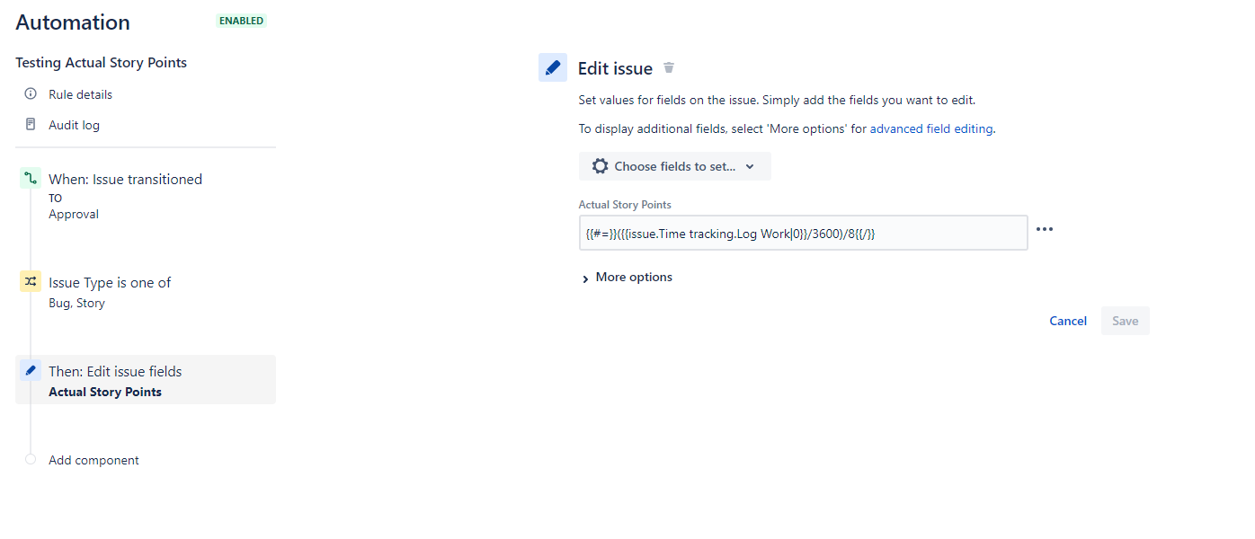

I have an automation in place that logs work between two statuses during the task workflow, which works great.
However, I now need to have the logged time converted into our secondary story point field when the task is transitioned to a specific status.
Based on my audit log, the automation 'works', however, my Actual Story Points field does not update with any values - Can anyone suggest or advise what I could try or where I'm going wrong, please?

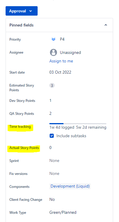

For context, below are the highlighted fields I am currently working with, along with my current automation rule.
For those that may be wondering, we use the dev and qa story points to pre-populate the estimated story points field (basically the same as the 'original estimate' field).

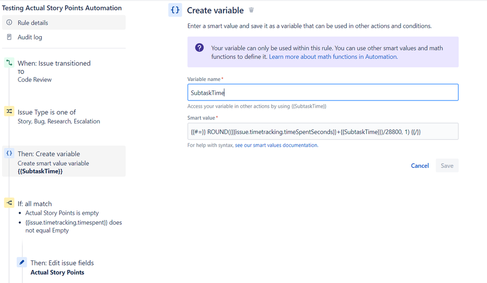

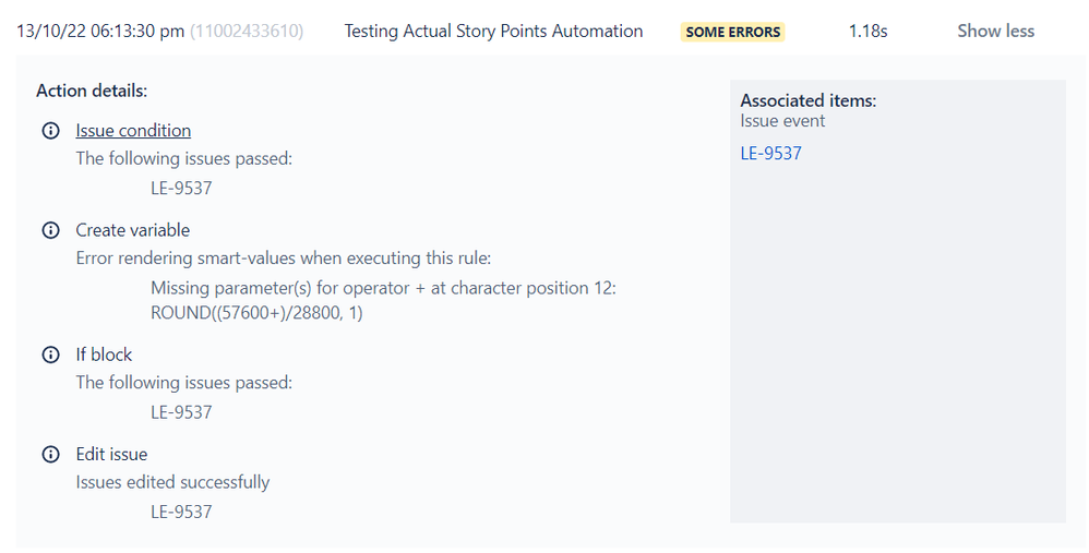

I've tried two methods for automating this, the first example is provided in my original post and the second attempt is attached below with an error.

Bill Sheboy
Oct 13, 2022
Your created variable SubtaskTime seems to be referencing itself in the smart value expression...and so that is null and causing the error.
