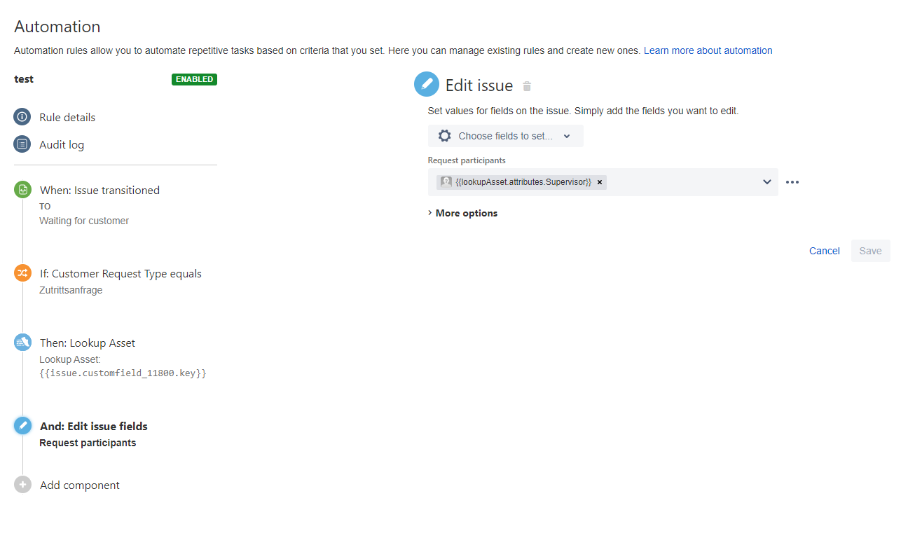

we have an actual problem:
We have an objectType in Assets that includes all employees with a few attributes. One of the abttributes is the supervisor as a user attribute.
Furthermore we have a customfield with the type "Assets readonly object" which shows the reporters employee object.
Now we want to build an automation that automatically fills the Request participant with the Supervisor attribute.
I have tried the following:
But it does not work an I've got an error message:
Do you have any idea about that?
Thank you!

Marko Blagus
November 4, 2023
Hello @Kaja Iske,
Do you retrieve the attribute from issue's custom field?
If that's the case you can try with {{custom_field_name.Supervisor}} to get the "Supervisor" attribute value.
For example if your custom field name is "Employee", try with {{Employee.Supervisor}}.
I hope this helps.
Best regards,
Marko Blagus

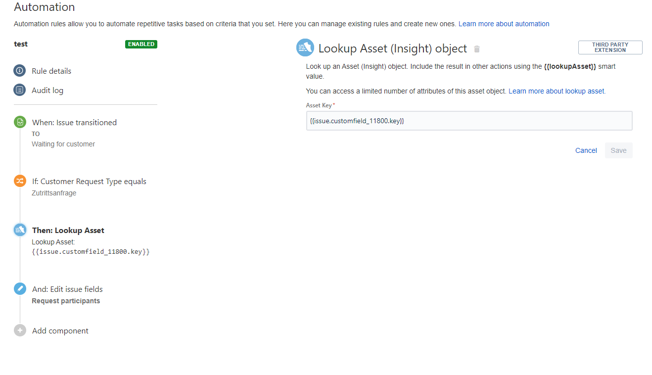

Kaja Iske
November 5, 2023
Hi @Marko Blagus ,
the custom field only shows the employee.
I've tried your idea but I get the same error message (No object with the key '' exists).
Best regards
Kaja Iske
Marko Blagus
November 5, 2023
Can you please send me a screenshot of your automation with my suggestion?
Best regards,
Marko Blagus
Kaja Iske
November 5, 2023
Marko Blagus
November 6, 2023
No, try to remove the step "Lookup Asset", just copy the value from Object's attribute to the field "Request participants".
For "Request participants" value try to put {{Employee.Supervisor}}.
Let me know.
Best regards,
Marko Blagus
Kaja Iske
November 6, 2023
Now I get "Success" in the Audit log but it has no effect. The Request participant has not been filled.

Kaja Iske
November 6, 2023
I tried your ideas in many combinations but it doesn't work. I think that I don't even get the correct value from the customfield, because instead of changing the request participants, I just had the text written in a comment. So far I have not gotten the correct supervisor back.
Kaja Iske
November 9, 2023
Hi,
so I was in contact with the vendor. There is a bug with Asset read only custom fields. When we use the normal Asset object it works. The way I used before (see my first description) was correct.
Thanks anyway for the support :-)!
Best regards
Kaja
