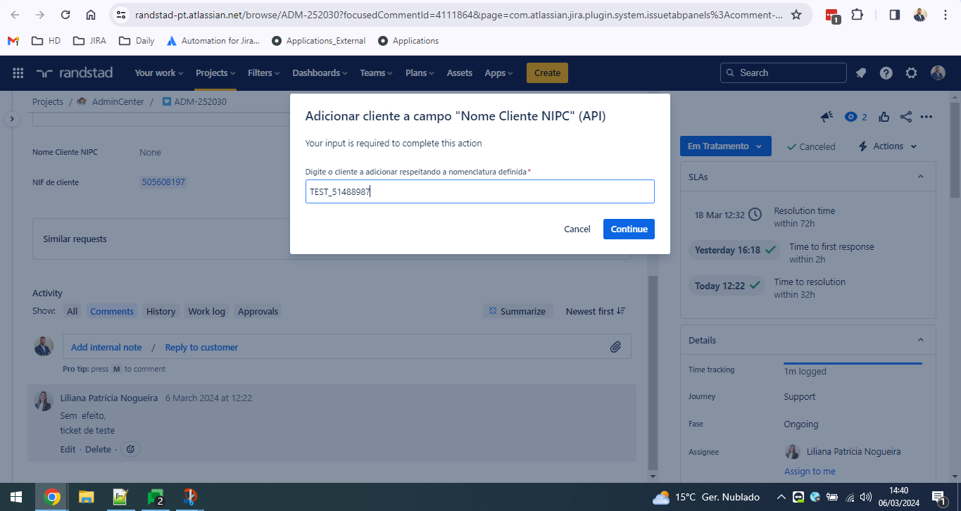

I have a manual automation that asks the user which customer/client they want to add in a custom field. The format that users will use to fill in the field is "NAMEOFCLIENT_IDENTIFICATIONNUMBER" for example: ATLASSIAN_123456789

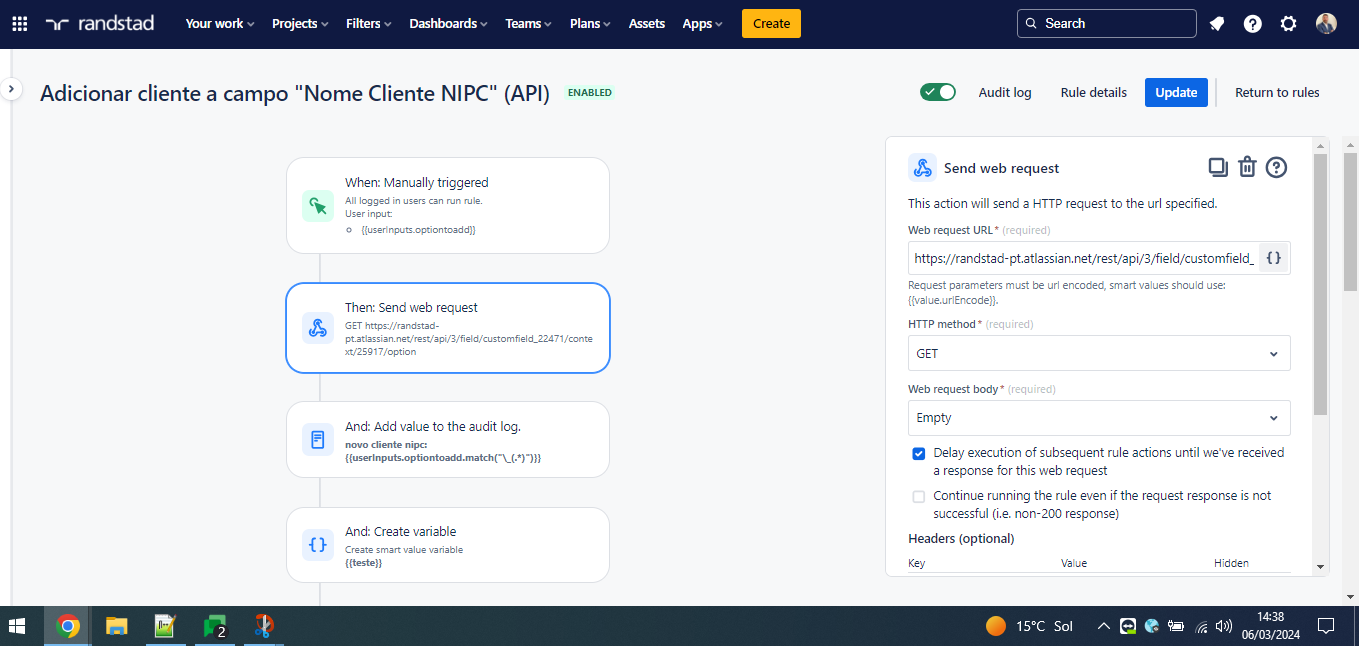

I currently have this configuration:
GET https://randstad-pt.atlassian.net/rest/api/3/field/customfield_22471/context/25917/option
the result of this is something like:
"maxResults":100,"startAt":0,"total":1216,"isLast":false,"values":[{"id":"45888","value":"2LIGHT-HEALTHCARESOLUTIONSLDA_514188987","disabled":false},{"id":"45980","value":"A.B.SOARES-INDUSTRIAMETALURGICA,LDA._505608197","disabled":false},{"id":"45426","value":"A.B.V.&MACHADOLDA_506804488","disabled":false},{"id":"45705","value":"A.J.P.-TRANSPORTESRODOVIARIOSDEMERCADORIAS,LDA._503603783","disabled":false},{"id":"45986","value":"A.J.PINTOII-DISTRIBUIÇÃO,LDA._507552393","disabled":false},{"id":"45698","value":"A.MOREIRA&FILHOSS.A._504431609","disabled":false},{"id":"45308","value":"ABANCACORPORACIÓNBANCARIA,S.A.-SUCURSALEMPORTUGAL_980464897","disabled":false},{"id":"45905","value":"ACCELPERCONSULTINGIBERIA,LDA_508992320","disabled":false},{"id":"45382","value":"ACCELYAWORLD,SLUNIPERSONAL_B08132516","disabled":false},{"id":"45149","value":"ACCENTURE-CONSULTORESDEGESTÃO,S.A._502309440","disabled":false},{"id":"45384","value":"ACCENTURE2BUSINESSPROCESSSERVICES,S.A._514711442","disabled":false},{"id":"46123","value":"ACCIONAPORTUGALII-ENERGIAGLOBAL,LDA_513143114","disabled":false},{"id":"45520","value":"ACCORDHEALTHCARE,UNIPESSOAL,LDA_508622263","disabled":false},{"id":"46237","value":"ACIBÉRICA,ACE_517838141","disabled":false},{"id":"45906","value":"ADEGACOOPERATIVADEMANGUALDE,CRL._500008558","disabled":false},{"id":"45513","value":"ADEGACOOPERATIVADEPALMELA,CRL_500008710","disabled":false},{"id":"45917","value":"ADELINOCAVALHEIRO,SOCUNIPESSOAL,LDA_507559126","disabled":false},{"id":"45678","value":"ADLA-ALUMINIUMEXTRUSION,S.A._509838740","disabled":false},{"id":"46168","value":"ADLANEXT,UNIPESSOALLDA_515147281","disabled":false}
For example, if the user adds a client as "TEST_51488987", how can I get the ID from the "value":"2LIGHT-HEALTHCARESOLUTIONSLDA_514188987" so I can update the option with "TEST_51488987"?
