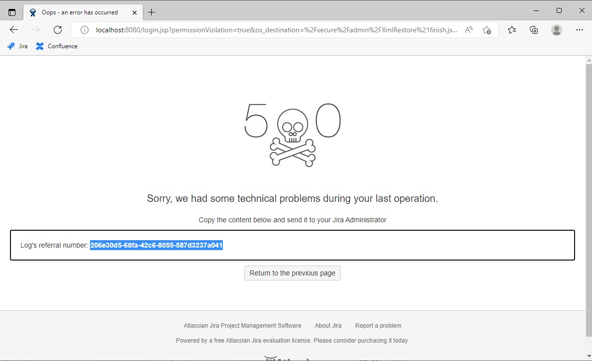

I created a VM on which I've installed Jira & Confluence Data Center instances. I then took backups of the source Jira & Confluence cloud instances. I then attempted to restore the Jira backup with the Jira DC instance. This is where I am now stuck. The restore gets to 90% and then I get a 500 error indicating a log referral number of: 206e30d5-68fa-42c6-8055-587d3237a041.

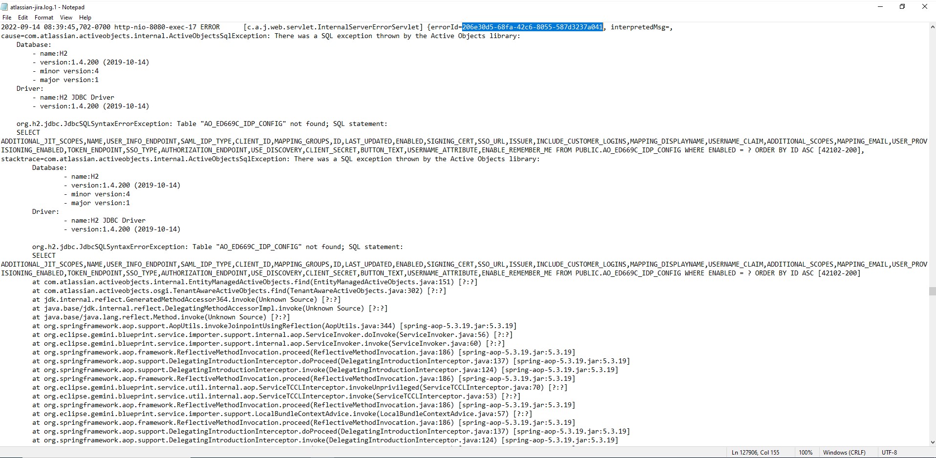

The log indicates that a database table was not found.
