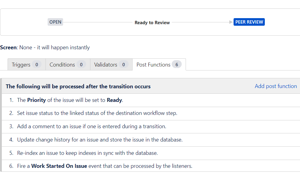

- The transition from Open to Peer Review looks pretty standard to me. Here are the Post Functions:

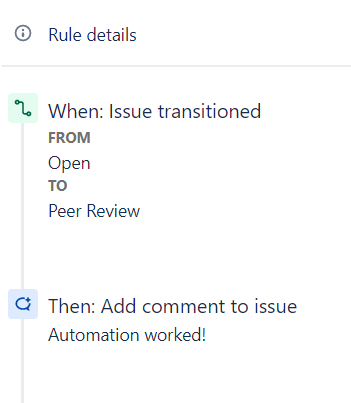

I am trying to setup an automation in my project so when an issue is moved from Column A to Column B something happens (assigned to a developer, comment made, etc). Because I couldnt get it to trigger, I tried a really simplified automation rule that did this:
But after several test runs, the comment never showed up in the issues. And the audit log shows it was never triggered. So then I changed the trigger in the automation to not limit to any statuses at all -- just any transition from one status to another, and again the audit log shows that was never triggered.
I have also tried to change the trigger from "Issue transitioned" to "Field Value Changed" looking at the Status field, but that did not result in any difference.
