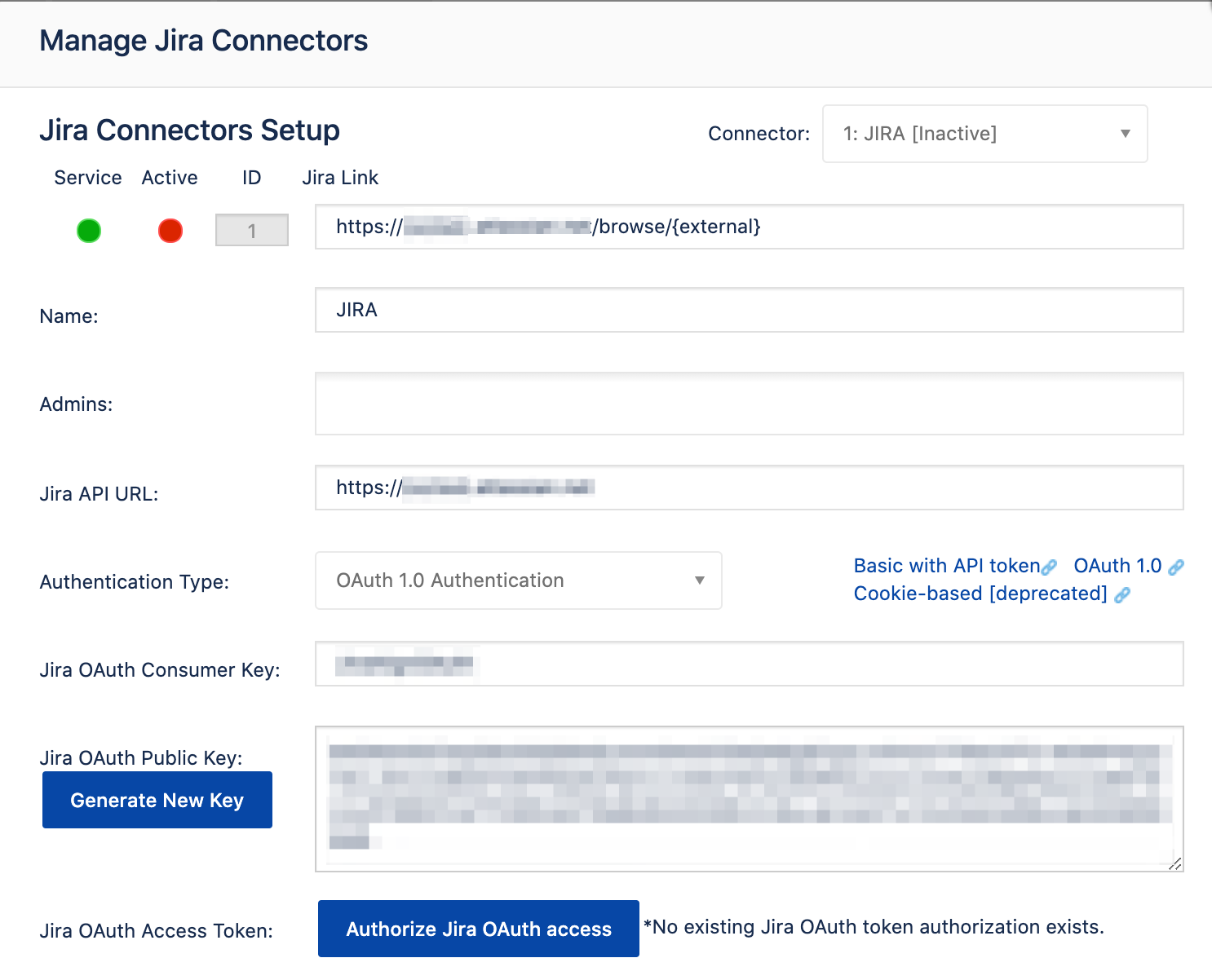

4) Fill out the Jira Connector as follows:
- Jira Link: https://<your JIRA Base URL>/browse/{external}
- Name: Anything descriptive. This is a vanity name only.
- Admins: Add any other Jira Align users that you want to manage this connector that are not Super Admins.
- Jira API URL: https://<your JIRA API URL>
- Note: If you are using a Proxy or API Gateway, this will be different from the Jira Link.
- Authentication Type: OAuth 1.0 Authentication (highly recommended)
- Note: If you are unable to use OAuth 1.0, you can skip the OAuth section later in this document and opt to use Basic Auth with the Jira Service Account username and password.
- Jira OAuth Consumer Key: Anything descriptive. Remember this Consumer Key for later.
- Note: Do not use spaces or symbols for the Consumer Key!
Additional Note: If the Service Light is gray and not green, then you'll need to contact Jira Align Support to activate the service before proceeding. Please include the connector type (Jira Connector) and Connector ID (Number).
5) Once the above has been filled out, click Generate New Key and copy it to your clipboard.
- Note: Some browsers have issues copying this block of characters so you may have to try a few times to get it in the clipboard. I've also found resizing the text box and then copying helps as well.
6) Click Save at the bottom of the Connector window. We are done with Jira Align for the moment.

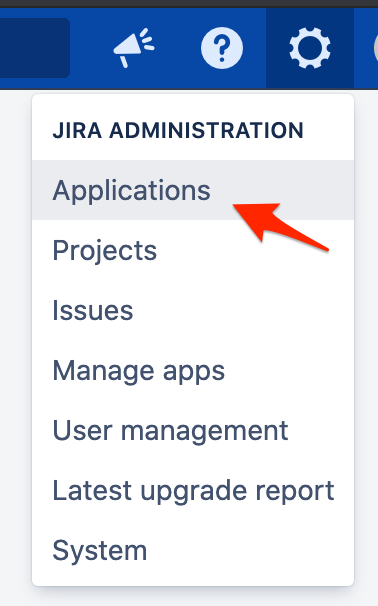

7) Login to Jira, click the Settings cog in the top right, and select Applications.

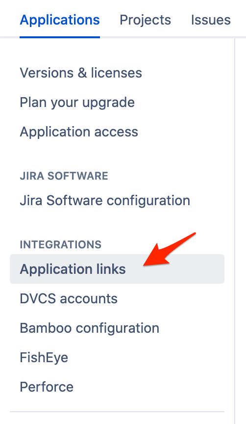

8) On the left column, under Integrations, click Application Links.

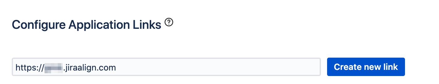

9) Enter the Jira Align URL (https://__.jiraalign.com) in the field and click Create New Link.
10) Jira Server/Data Center may complain there was no response. Just click Continue.

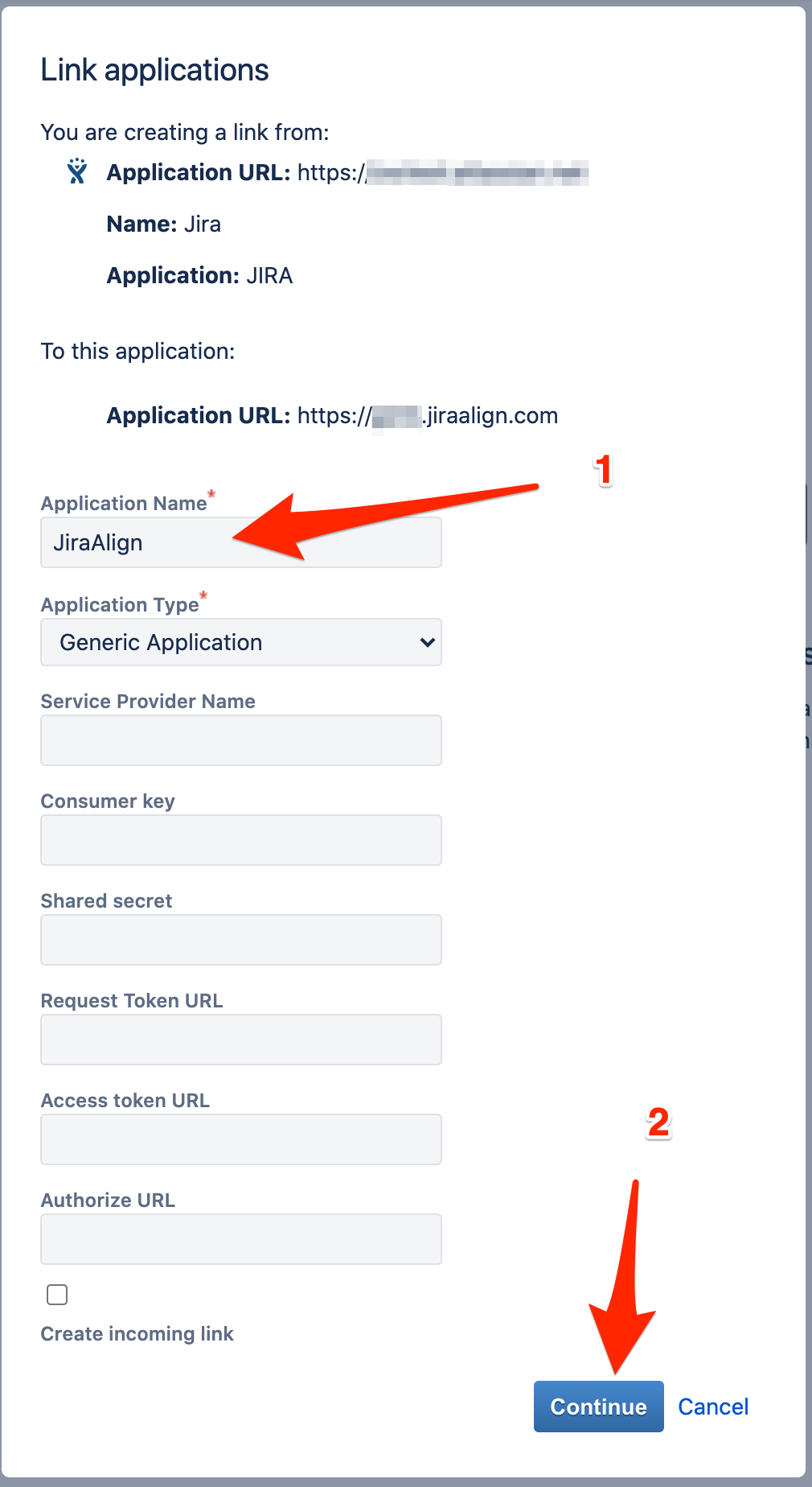

11) Fill out the Application Name with something descriptive.

16) Go back to the Jira Align Connector window from step 4.
17) Click Authorize Jira OAuth Access.
Note 1: If a Jira OAuth token authorization already exists, the button will display as Reauthorize Jira OAuth access. Clicking this will perform the same process of generating a fresh OAuth token.
Note 2: You will see this request go through 3 steps and will refresh several times. It will take a few minutes for this process to complete.
Note 3: If you are having trouble with this step, make sure that the Consumer Key matches on both sides and contains no spaces or symbols.
In addition, check that the OAuth Public Key are an exact match on both sides.
Lastly, make sure that the Application URL configured in the Jira Application Link is correct without any typos.
See OAuth Error During Setup for more troubleshooting tips.

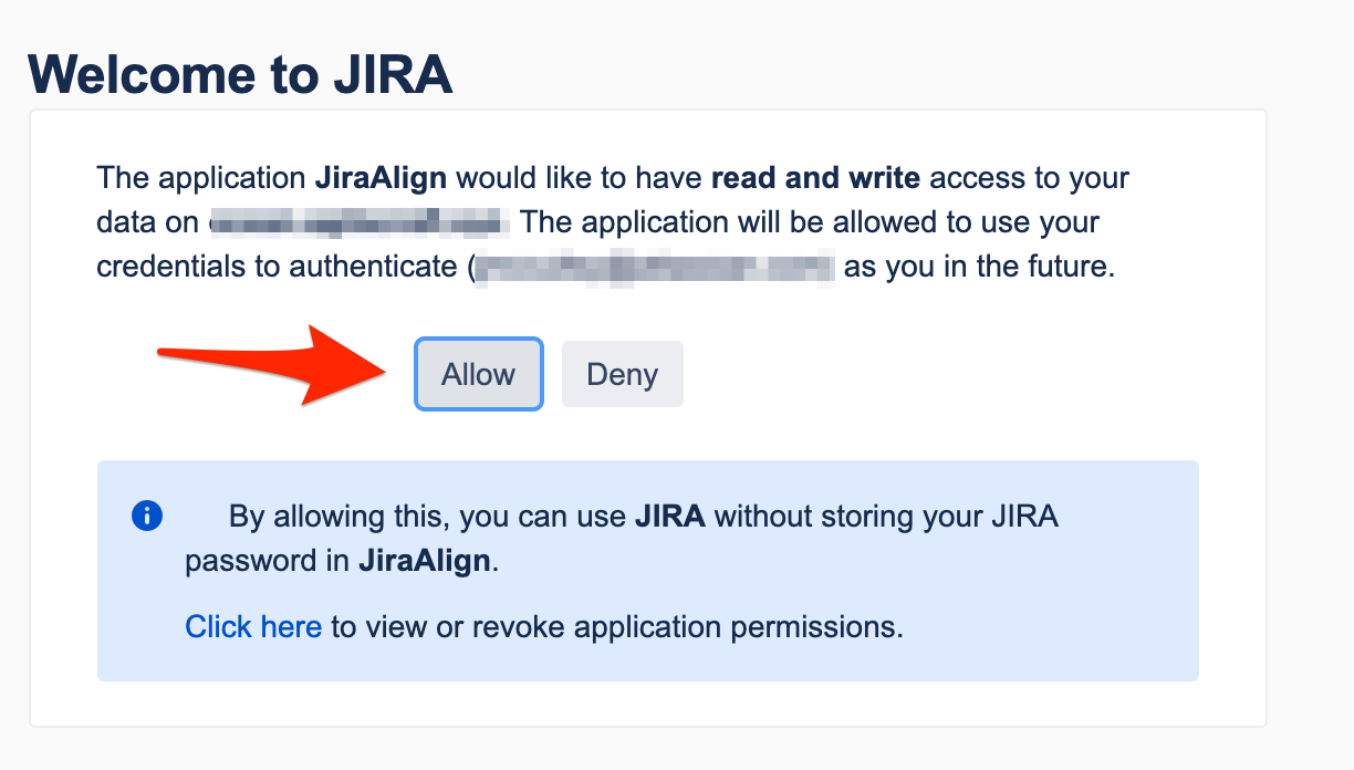

19) You'll be taken to another tab asking you to allow the application to have access. Click Allow.
