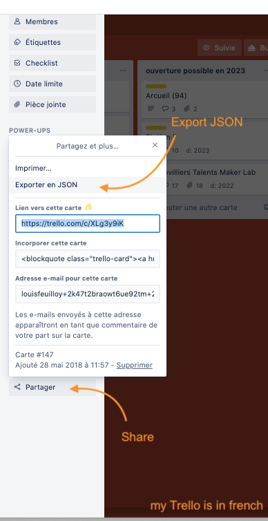

i found the solution : you can find the JSON file in the share options of the card, there is all the historic of the card

Louis FEUILLOY
July 24, 2020
Minh Như
July 24, 2020
Oh, I saw!
Thank you so much!!!
