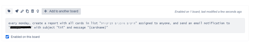

Hello again,
I really don't understand why it doesn't send me any lists and the email arrives empty, what am I missing in the setting, it shouldn't be that complicated

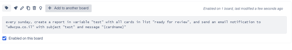

Hi,
No matter how many times I tried, the email comes empty...
I am attaching the Settings I made.. what am I missing?
Mike - Dreamsuite Consulting
May 23, 2023
Can you try this:?
Put this emoji at the beginning of the list name 📧 and then change the automation to create a report with all cards in list "📧{*}"
Also, I notice you have "assigned to anyone" Are the cards in that list all assigned to at least one member? You could remove that condition and try re-running it to see if that works...

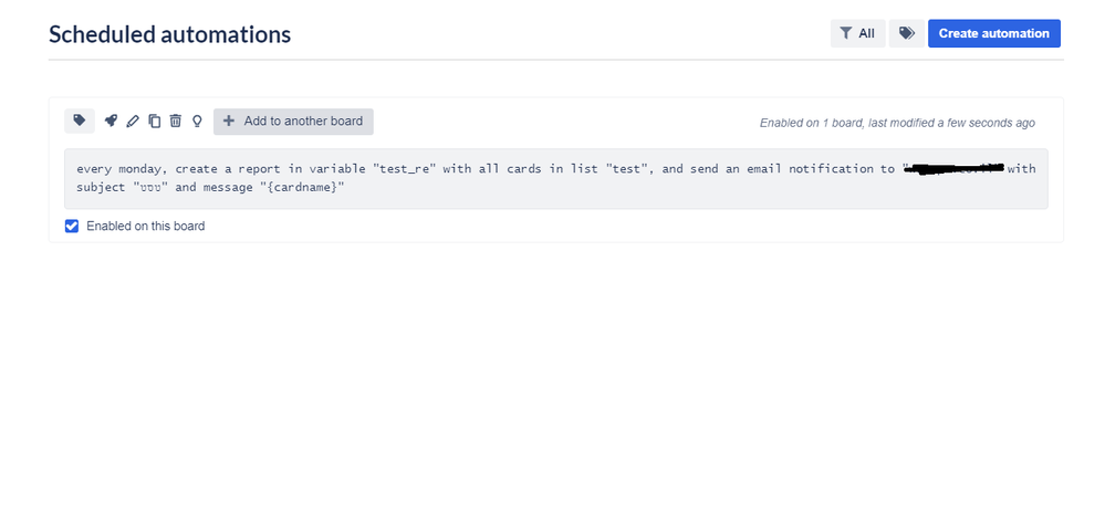

שי - משרד
May 24, 2023

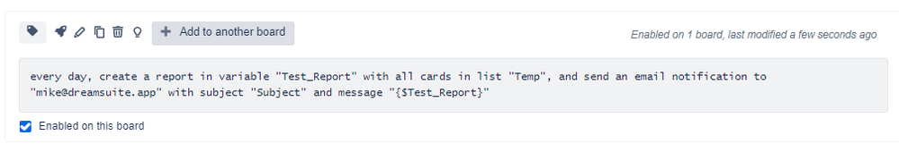

Sorry, I missed it the firs time round. You have not included the report in the email you send. The automation has to use the report pattern as a reference as shown below:

You have to have the message reference in the email message:
For yours it will be {$test_re}
Your full automation will be:
every monday, create a report in variable "test_re" with all cards in list "test", and send an email notification to [email] with subject "uuu" and message "{$test_re}"
שי - משרד
May 24, 2023
I can't believe it works (-: Thanks for your patience
