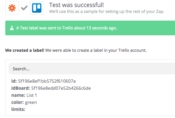

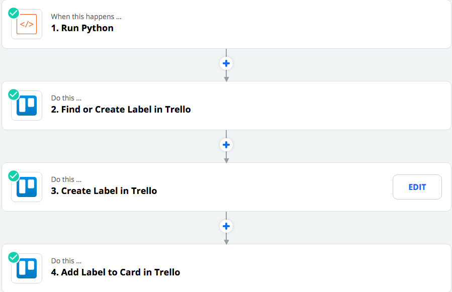

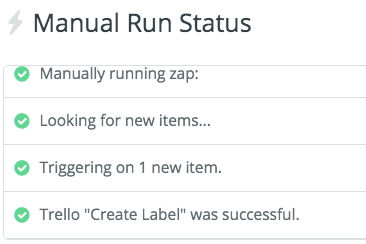

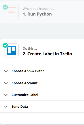

Can you print the zap page so I may learn about this issue? I tried several zaps to try to create a label with same name and colour but it did not allow me. Here's what I did. The run python output Name and Colour of exist label. Although it says that Label was created successfully nothing was created.

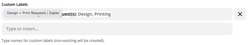

Here's the part that's not working right. Note that it says that "non-existing will be created." Well on my board, both "Design" and "Print" already exist as labels that are pink and blue respectively.
When I run the zap, the card gets created and the two labels get applied but not correctly. It creates duplicates of these two labels with the same names and no colors. So it's something related to the handling of the label color.

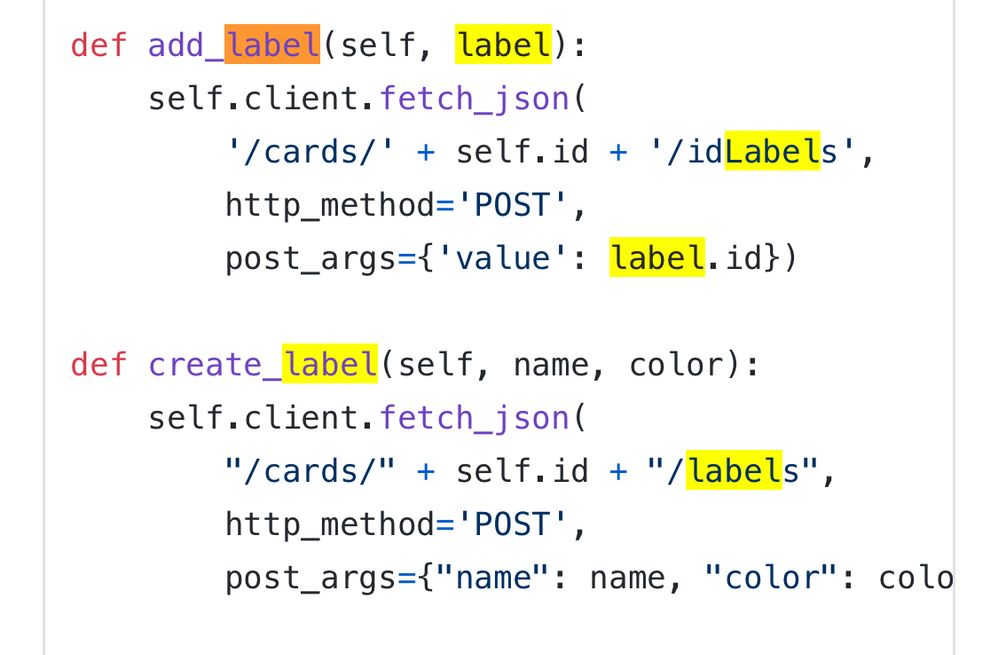

So far my tests in Zapier on labels are consistent with my programming in a Trello using py-Trello. The important distinction is between add and create. Add you need to identify the label object and create you supply the name and colour. In my test above I used zapier python to supply name and colour and even when label exist it does not create another. In your picture, it is not obvious to me that you have supplied both. If Requests and Design are label objects in Zapier terms that it should work but if they are just Text then it will not.

I used Run Python to represent what the form needed to have done. ->output a label name and colour and have Zapier Find or Create Label. Here it will only create a new label if one of that Name & colour does not exist. Then the next zap pickup the Label object which will be available as  Name(color).
