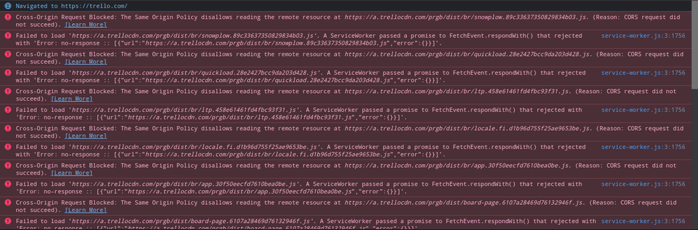

I'm not sure if it's the same problem or not, but I have had problems with Trello not loading after I have logged in. So, logging in technically works, but actually using Trello is not really possible because the page does not load.
I have traced this problem to the service worker that trello.com registers on first load. During subsequent loads, the following errors are displayed in console:
Using private window helps because the service worker will not be used. According to technical documentation about service workers: ”In Firefox, Service Worker APIs are also hidden and cannot be used when the user is in private browsing mode.” (Source: https://developer.mozilla.org/en-US/docs/Web/API/Service_Worker_API)
It would be great to have a real solution to this and not need to work around with private browsing or disabling service workers completely.

Lliehu, THANK YOU!
You really have identified the problem here! As you said, I can log in, it's just loading the page that's the issue. Sometimes I could see my board, but when I click on the cards it would stop responding.
I've just tried your suggestion of using a Private Window, and it works!
