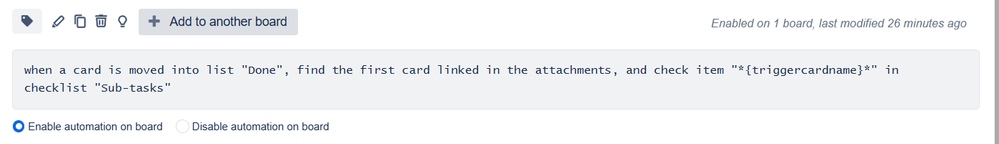

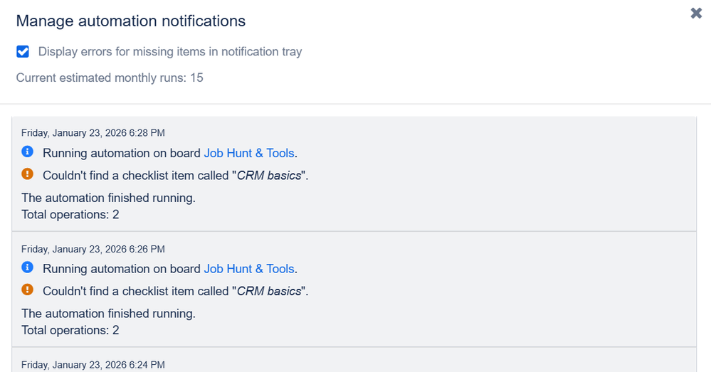

This is the rule that I set. I checked for typos multiple times and I tried changing the variable multiple times. I have a parent card that is attached to each child card, and the items of Sub-tasks checklist in the parent card consists of links for each child card. I'm new to this, pls help Trello rule.pngTrouble.pngTrello.png

DiMaggio Tucci
January 23, 2026
Hi @Jovana
I tested it, the issue is 100% that you have those '*'s in there.
Just use {triggercardname} instead of *{triggercardname}*
When you use those '*' symbols, Trello is looking for other content there. See my other answer for more information.
Jovana
January 24, 2026
Thank you for your reply!
I tried it without "*" initially, but it was the same. Tried it now again and it still says Couldn't find a checklist item called "CRM basics".
I tried different variations, including [{triggercardname}]({triggercardlink}) and {triggercardlink}, when I use the link, it says Couldn't find a checklist item called "https://trello.com/c/t72MAqbV(or CRM basics with the internal link). When I open the link, it leads to the card (in both cases). Is it possible that I didn't direct it to the parent card correctly?

I tested it and I was correct that this was the issue. I had the exact same behavior with the stars, and got the behavior you wanted when I removed them. Bear in mind this means the title of the trigger card has to match the checklist item exactly, but it seems like, from your screenshot, that is the case. The "*" symbol is used when there is some other text there, in this case, before and after {triggercardname}
This is just a theory; I haven't had time to test this yet. I'll remove this answer and add a new one if I find out something else. But maybe you can try this in the meantime?
I think it could be the "*" that is the problem.
According to the article about wildcards:
Using wildcards in automation triggers
In an automation, the wildcard is the special sequence that matches any text in the card name or description.
Automation supports several types of wildcards:
  • {*}: this wildcard will match any text with blank spaces. Typically, it is used to match the text at the end of a card name or description.
  • {* }: this wildcard will match a text until a blank space or the end of the text. Typically, it is used to match the text at the beginning/in the middle of a card name or description. When using this wildcard, make sure that you include a blank space in between the asterisk and the closing bracket.
  • {?}: this wildcard will match the minimum amount of text.
I think what you're looking for it to just use
{triggercardname}
It seems like you just want the card name, so I'm not sure why you'd need the symbols at all.
