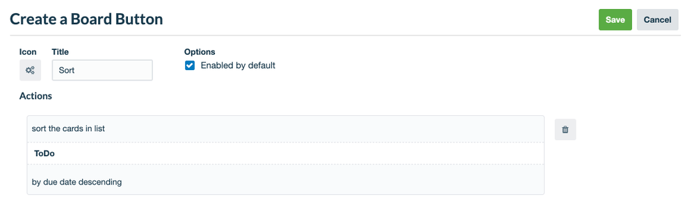

Iain Dooley
May 6, 2020
@Christine Burleigh yep you can do this with Butler, for example you can use a Board Button:

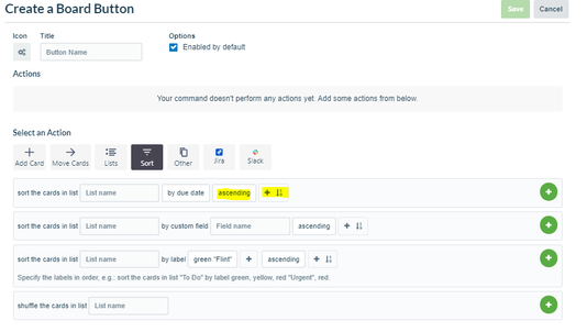

Christine Burleigh
May 8, 2020
I'm part way there, but need further direction.  When I try to create, I have the following options available, but don't see how to create my own new one with only "sort descending".   I can change from ascending to descending, but cannot delete/change the last function at end.
Christine Burleigh
May 8, 2020
Christine Burleigh
May 8, 2020
@Iain Dooley
I figured it out!   The last function button, at end, is IF you want to add another level.
Thanks for your help!
