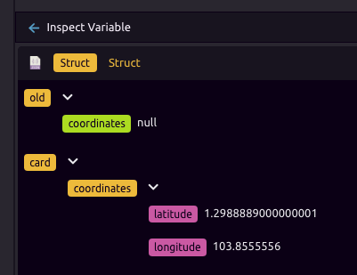

milynnus
August 4, 2020
Information still via webhook with trigger on the platform I am using. Using webhook, you can get the initial coordinates and also name and coordinate changes
milynnus
August 4, 2020
[{'id': '........', 'data': {'old': {'coordinates': {'latitude': 1.2988889, 'longitude': 103.8555556}}, 'card': {'coordinates': {'latitude': 1.3196178, 'longitude': 103.865015}, ......... 'data': {'old': {'address': '200 Victoria St, Singapore 188021'}, 'card': {'address': '994 Bendemeer Rd, Singapore 339943', ..........
Here's from using
`card.fetch_actions(action_filter='updateCard', since=None, before=None, action_limit=50)`

milynnus
August 4, 2020
@Hal Atkins  Since pluginData is not available you will need to have a different way of exposing the location information. Based on the above, the first step is to get a webhook or trigger program to extract the information and update some custom fields on the card. Set it up such that it can also handle changes after the initial setup. Once you have them on custom fields you can use it in Butler. There is a limitation in using lookup cards for custom field. You might need to use an add on that I have. See video below.
https://youtu.be/YsOEdbsdgn0
let’s get connected should you want to work through this.
