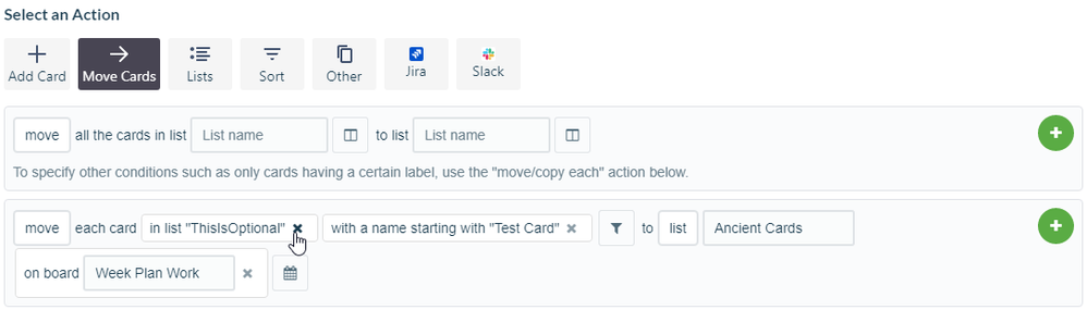

Board Button > Move Cards > Move Each Action
The test case as stated works perfectly fine? It just doesn't require the use of wildcards.

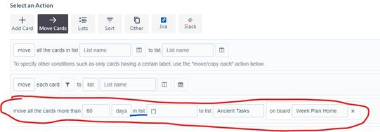

That makes sense. The problem now is that I want to make a command that will move all cards that have been on any list on a particular board for more than 60 days onto a central "Ancient Card" list. Unfortunately, the Command Creator only seems to offer a card age option with the "in list" criteria. Your excellent explanation makes it seem like there is no way to make this work. Here's the Command Creator that I need:
Do you see a way to do this with one of the Command Creator options?

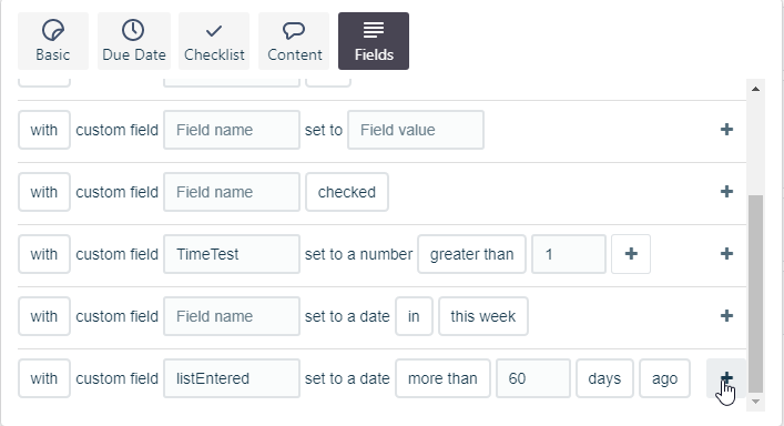

You can get the same "card age in list" functionality with more flexibility with an additional Rule and the Custom Field powerup.
(Edit: as an aside, my previous wildcard explanation is still pretty bad.. The wildcard usage below I'm guessing works because the actual trigger is the card moving, then it checks the current list fits {*}. Whereas your screenshot above first looks for a single list {*}, before checking card age. If that makes sense)
Set a Rule: When a card is moved in to list {*}, set date custom field "listEntered" to now.
Set a Board Button: Use the old Move Each command, with a filter for "listEntered">60 days ago (Should probably also add a filter for not in list "Ancient Cards" so it doesn't repeatedly trigger off of old cards)image.png
There's not a whole lot of flexibility in the card age area in general though, so it can be a bit difficult to finagle a good solution. For instance there's no way (that I know of anyways) to access a "last updated" variable. Its doable, just requires a ton of rules to cover all things you'd consider "editting" which will eat in to operations by a lot. Due Date is another potential avenue as well, but I've been using Custom Fields instead of that so not sure on that.
