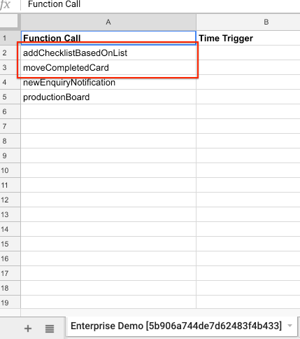

Then on any board where you want this behaviour, just put the function names:
addChecklistBasedOnList
moveCompletedCard
For example here are those 2 commands installed on my enterprise demo board:
If you wanted to install these commands for any board Trellinator is a member of you could also put them in the Global Commands tab (I won't go into more detail than that right now but there is a "global command group" feature that allows you to install the behaviour for a group of boards, too).

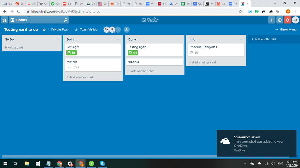

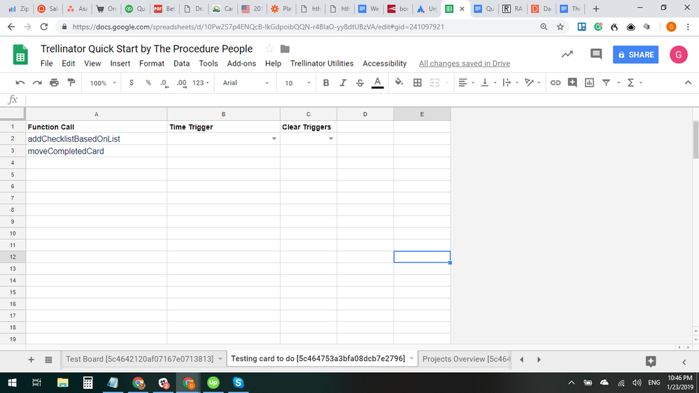

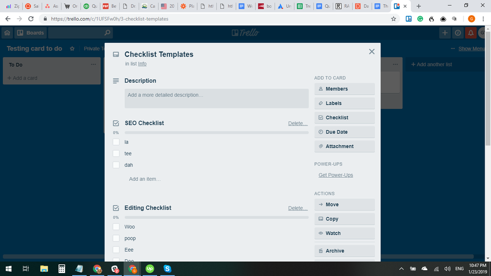

@Iain Dooleyso I checked and it's not option 5 but something isn't working just yet. I'm putting in some screenshots. I've looked at everything but maybe you see the problem.

@Gabrielle Yoder you have checklists called "SEO Checklist" and "Editing Checklist", but you have lists called "To Do", "Doing", "Done".
The names of the lists need to match the names of the checklists.
So for example if you have a list called "SEO" and a checklist on the templates card called "SEO" it will work.

@Iain Dooley ooooooh! Okay. I was wondering how those would match up. It was a big question I had on how it would know to put what where. That knocks out two in one right there. It's working now.
