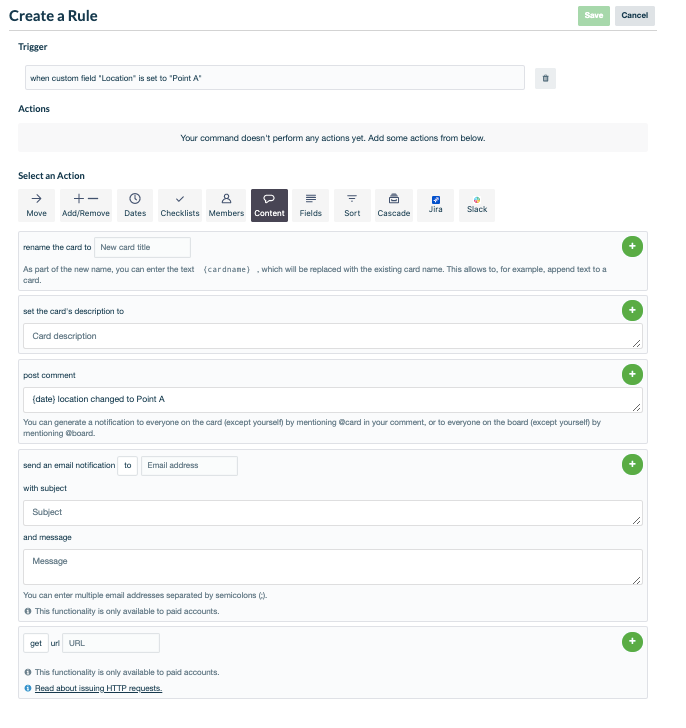

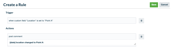

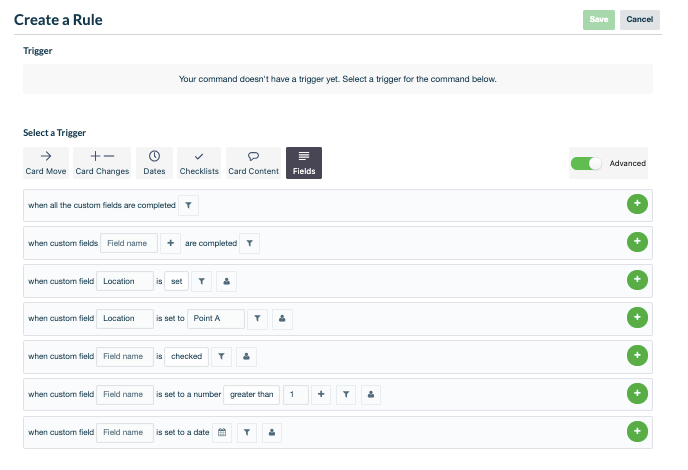

If you did it this way, you could then have a Butler rule based on a change in the custom field. That's what's going to take the time, setting up the rules for each location. Again, once you've set up one, you'd just have to go back into the rules, click on copy and change the details.
This is what the rule could look like:
I use the Butler variables, that way, you'll always get the right {date}, here is a link to the variables, you could have the date format set to whatever you like, you could even have a string;
