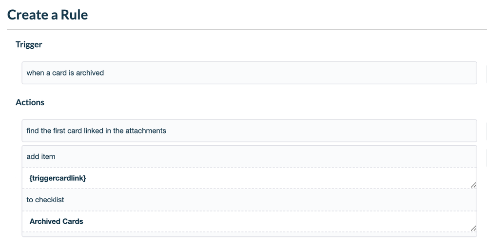

Sorry, I should have included the step by step!

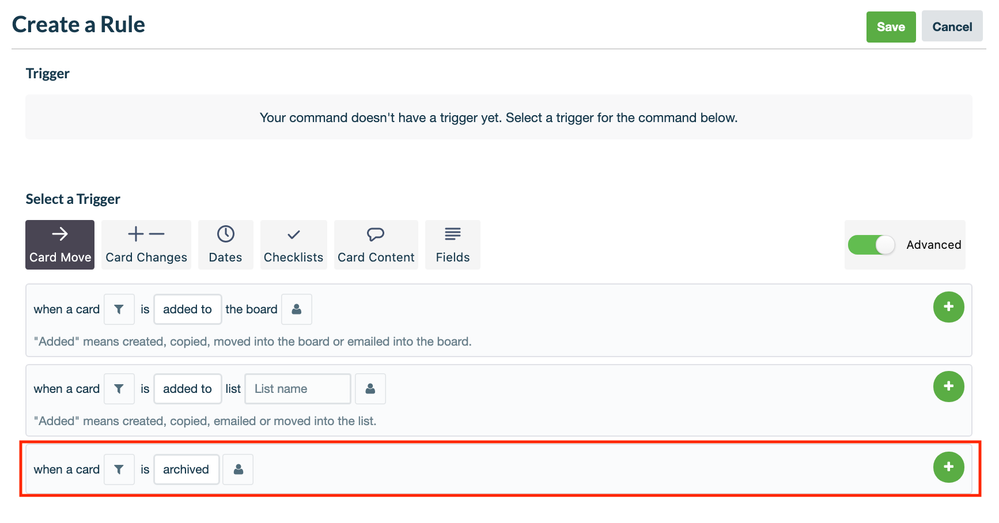

So the trigger you want is 'when a card is archived:

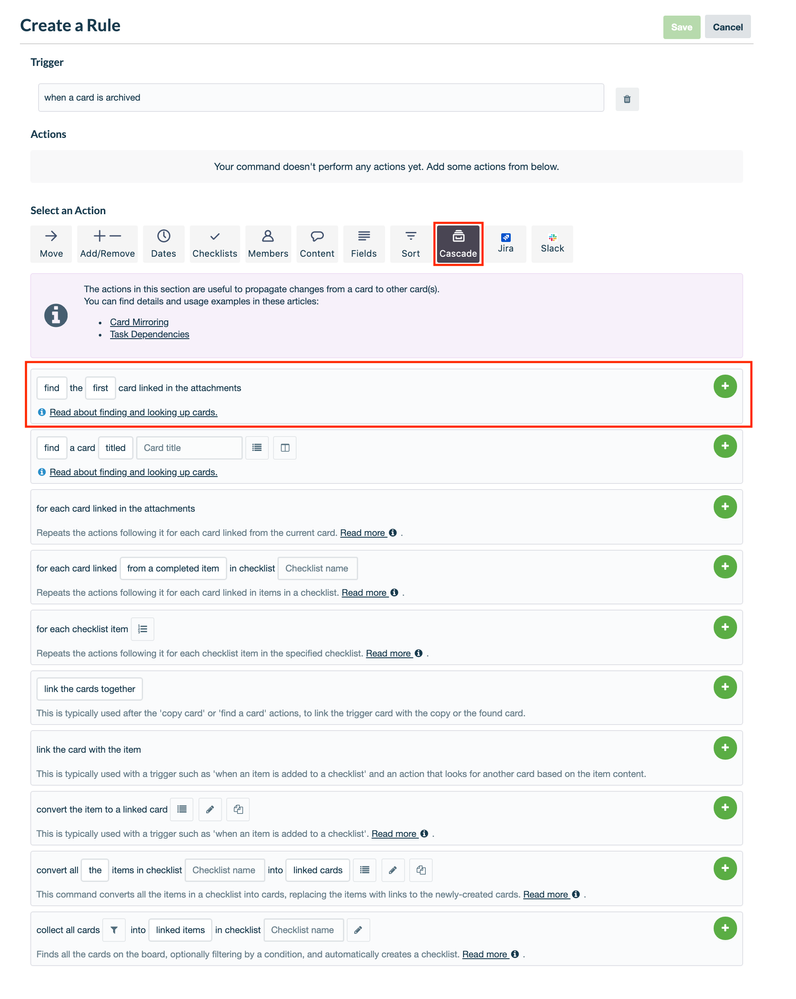

Then you want to cascade it to finding the first card in the attachments:

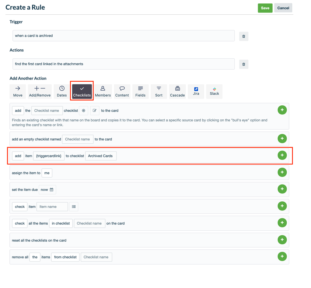

Then you want to add the card link (which will automatically change to the name of the card and add it as a clickable link) to the checklist:
If it was me, that's how I'd set it up!

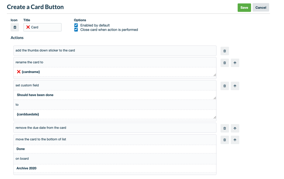

You could, if you wanted, create a card button that you could click that would automatically add the right month card. You'd have to change it every month, so that the right month would show up, but it would be totally do-able.
My set up, having a year board and each card being a month is set up slightly differently.

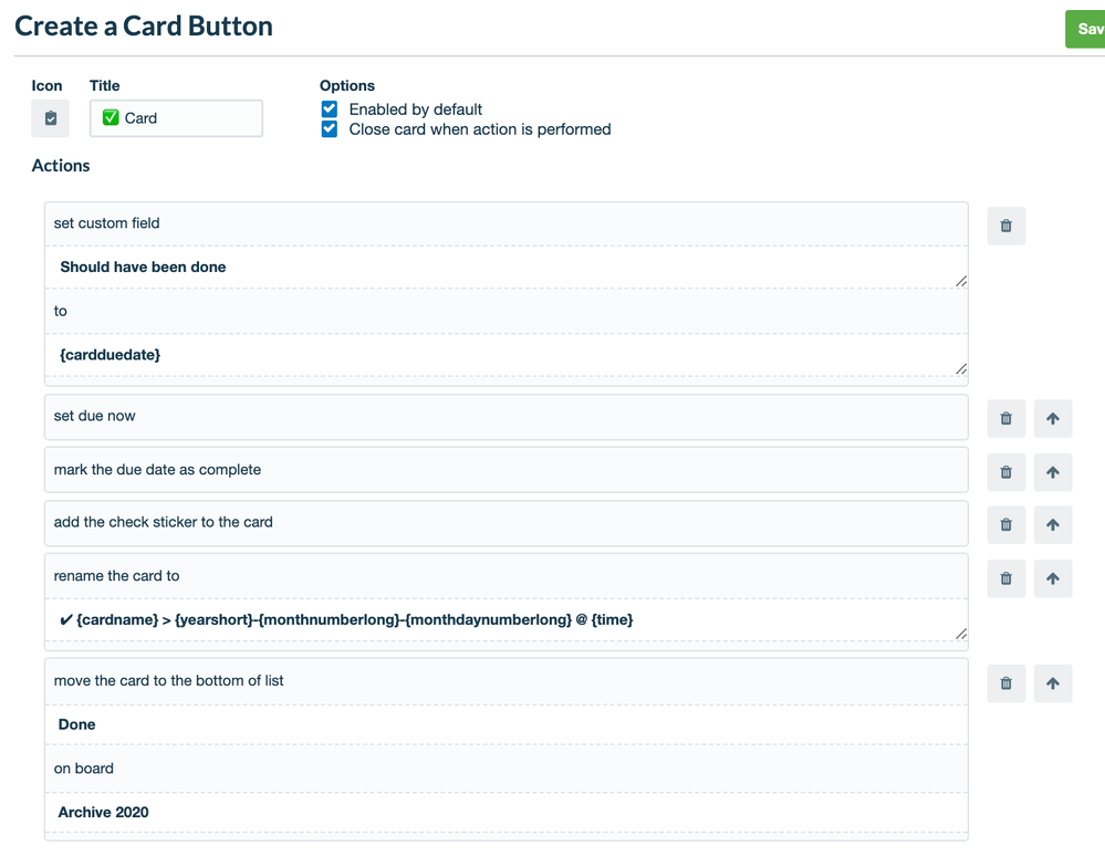

I have card buttons for 'done' and 'not done' that look like this:
As you can see, there are a couple of actions that run - I rename the card, some other things, and then I move it to the 'Done' list in my Archive board.
This gets any card across all my boards into this list, my card buttons are enabled across all boards, so that the process is seamless.
So no matter when I complete something, it'll go into the right list on the Archive board and be there in full should I need it.

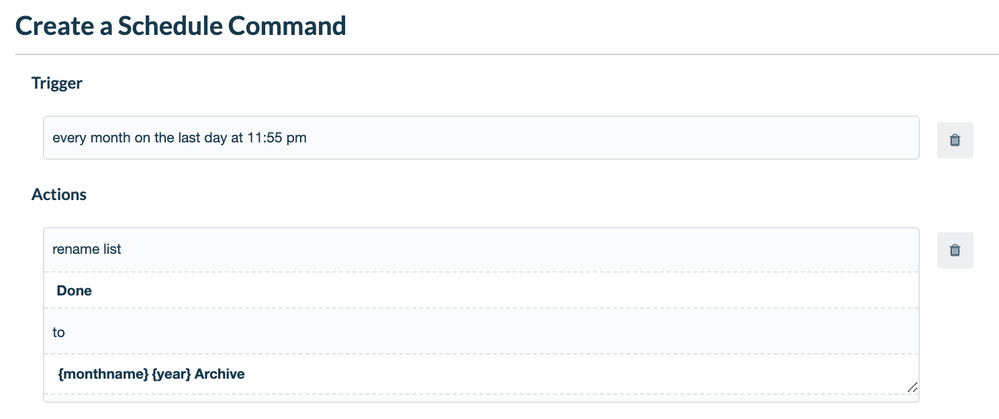

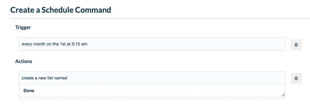

So my first calendar rule runs like this:
Every month, on the last day (at pretty much the last moment) Butler renames the 'Done' list to the month and year.
Then a few hours later (when I aim to still be asleep!), it creates a new list called 'Done'.
This repeats every month for the whole of the year.

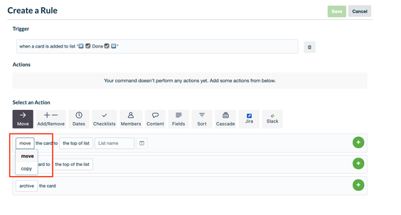

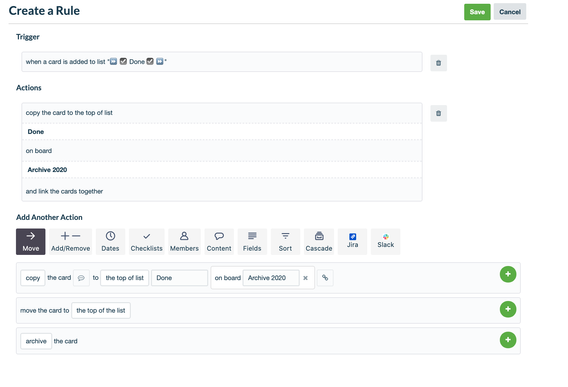

The issue I'm having now is that there seems to no longer be a way to copy a card to another board instead of moving it.

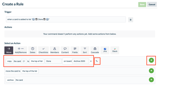

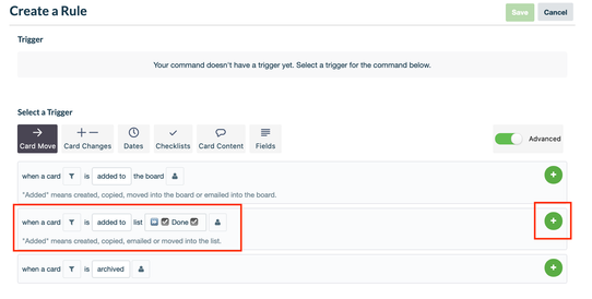

If I understand you right, you want to move a card into the 'done' list on BOARD A and when that happens, have it copied into an Archive board? So that you can still see everything on the board, but there is a copy safe in another board, then archive the list when you're ready?
If that's the case, this is what I would suggest something along the lines of this:
Screenshot 2020-05-02 at 20.16.52.pngScreenshot 2020-05-02 at 20.17.00.pngScreenshot 2020-05-02 at 20.17.28.pngScreenshot 2020-05-02 at 20.17.50.png
So that would mean that any time a card was added to the 'done' list on whichever board the rule is set on, it would copy the card to the 'done' list on the Archive board and link them together.

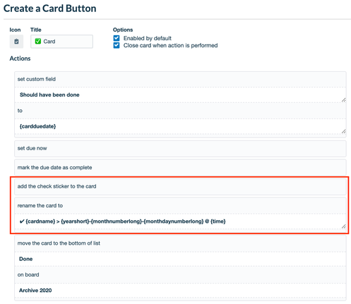

Also when I try to rename the card to {triggercardlink} it is not hyperlinked. The card name changes to the link of the card, but it is not a clickable link. I wanted to make sure that was something I could do.
Unfortunately, card names aren't clickable, so the command you're doing is perfect, but because card names don't understand clickable links, it won't work (unless you have a Chrome extension which makes them clickable - but this will only work on Chrome, so if you use the native Trello app on Mac, Windows, iOS or Android, they wont' work there).

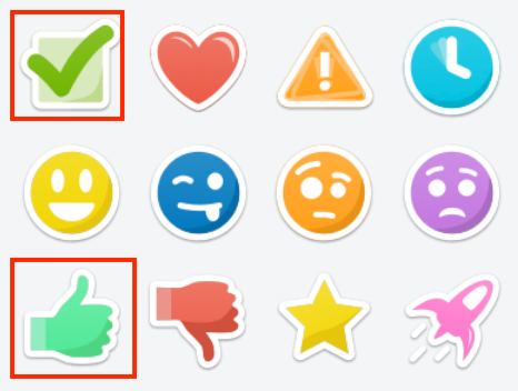

There are visual ways that you can confirm that the card has been done, that can be achieved with Butler - you could rename the card with an emoji (I do this!), something like: ✅ or ✔️ or ☑️ at the beginning. This is how I run it:
Obviously, mine is a card button, but it can just as easily be a normal rule, something like, when a card is added to the 'done' list as a trigger, then everything else can be actions.
You could add the thumbs up sticker or tick - both of which can be part of a Butler rule:
