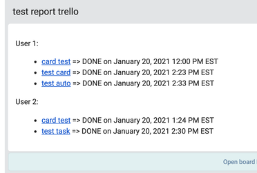

Marc Ientilucci
January 20, 2021
i have it set up in a test board and its almost the way i want it, minus a couple variables which i am going to play with.
create a report in variable "User_1" with all cards in list "Done" with custom field "Assignee" set to "User 1" using pattern "- [{cardname}]({cardlink}) {{Assignee}} => DONE on {{%Completion Date}}", create a report in variable "User_2" with all cards in list "Done" with custom field "Assignee" set to "User2" using pattern "- [{cardname}]({cardlink}) {{Assignee}} => DONE on {{%Completion Date}}", and send an email notification to "marc@sdhcap.com" with subject "test report trello" and message "User 1:\n\n{$User_1}\n\nUser 2:\n\n{$User_2}"
i know some of the cards below have some of the same card names, but they are different cards. i just used the same name while testing. this can be identified by the completion date.
milynnus
January 20, 2021
@Marc Ientilucci
if this what you want, sureyou can do that. If I am not mistaken, members on a card are stored as a string of strings (iD). 👏
As to sorting, you probably use different select criteria. So it is more like categories representing different set of cards.
