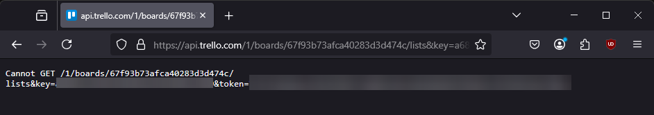

I'm writing a script using the Trello API and I'm trying to get the lists on a board. I'm following https://developer.atlassian.com/cloud/trello/rest/api-group-boards/#api-boards-id-lists-get . However, no matter what I try, I always seem to get a 404 error. I've confirmed that the board exists and that I'm using the correct id, key, & token (they're working for other API endpoints). Here's my (sanitized) URL:
GET https://api.trello.com/1/boards/67f93b73afca40283d3d474c/lists&key=KEY&token=TOKEN

Ok, I FINALLY figured out what I was missing - I was missing a ? to start the query part of the URL. So instead of /boards/[id]/lists?key=.... I was using /boards/[id]/lists&key=.... Very easy to miss and hard to see the difference.

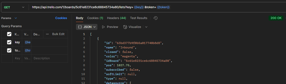

Just tested, and it works totally fine for me (using my own board-id), so the format of you GET URL is correct.

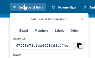

  2. Double-check that "67f93b73afca40283d3d474c" is indeed a board-id and not something else (a list-id or card-id). The easiest way is to get this powerup: https://trello.com/power-ups/646cc3622176aebf713bb7f8 and grab the ID on the board

Yeah, I also tried this in the browser with the same result. I did also confirm the id is the board id by exporting the board to json and looking at the info there. I quickly tested with the powerup you linked and it shows the same id:

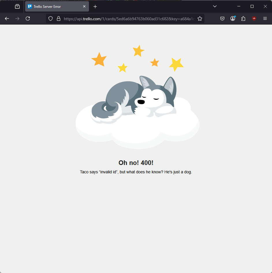

I realized my script only calls GET for this one endpoint, so I decided to try other trello GET endpoints. Calling this one to get a specific card seems to keep giving me 400 errors (even though I just grabbed the id from the card): https://api.trello.com/1/cards/5ed6a6b94763b060ad31c682&key=KEY&token=TOKEN
