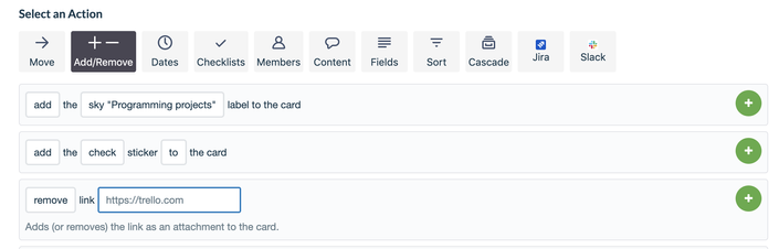

I believe you will need to be watching all of the cards to receive notifications, but you can watch all cards on a board by watching the board (go to 'show menu' and click 'more' you should see this option), or you can watch specific lists by clicking the three dots on a list and selecting the watch option!
As for removing attachments with Butler, I was thinking you could maybe do something with the action item for removing a link?  (See below). But I'm not 100% sure that would work or how you specify what attachments to remove.
Countess Olaf
May 18, 2020
Hello again. I tried the remove link option, but still no workaround so far. My trigger is when a card is emailed into the board because the confirmation email I get from my appointment software includes two links so I'm not sure if maybe the trigger is incorrect or if it does not work with that particular action.
