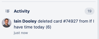

@KRepair you can modify these instructions for recovering a changed description:
https://help.trello.com/article/783-recovering-the-description-of-a-card-that-has-been-changed
to see a list of card deletions for a given board. You just construct your URL like this:
https://trello.com/1/boards/qTCYep6l/actions?filter=deleteCard
where "qTCYep6l" is the id of the board that you get from the board's normal URL in your web browser like this:
https://trello.com/b/qTCYep6l/iaindooley
You also don't need an extension to format the json output, I use this site to view it:
http://jsonviewer.stack.hu/
you can see the name of the person who deleted the card under the "memberCreator" chunk of data.
You can see the card id, card shortlink and the list it was in when deleted, as well as when the deletion occurred but you can't (obviously) see any data *about* the card, which can make it tricky to pinpoint which card was deleted when if you delete lots of cards.
You can also see the history of card deletion in the board activity feed:
https://help.trello.com/article/822-the-board-menu
It shows up like this:
Unless it happened recently or your board is not very active, however, you may find yourself scrolling a LOT and looking for a needle in a haystack, so using the JSON view of all deleteCard actions I gave above is probably better in that case.
