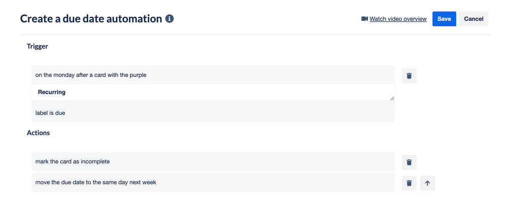

I am trying to run a scheduled automation on my board and it seems not to work.
I want all the cards with a specific label that have due dates and are marked as complete to change every monday to incomplete and move the due date to next week.
The below automation works only on incompleted cards. This issue should be fixed.

This isn't a scheduled automation, it is a Due Date automation and by design this only triggers on incomplete cards.
What you're trying to achieve is possible but I'd need to know more about how your board is set up.  Do you have lists based on workflow (To-do, doing, done etc....)?

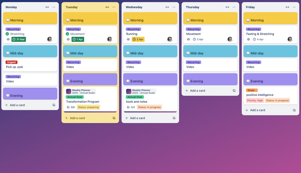

I have a board with my weekly tasks, so every list is a Day of the week and I have some cards that are recurring tasks, so they are the same every week.
I want to be able to mark them as complete when I do them and then on every first day of the week to reset them to incomplete and change the due date to next week same day.
