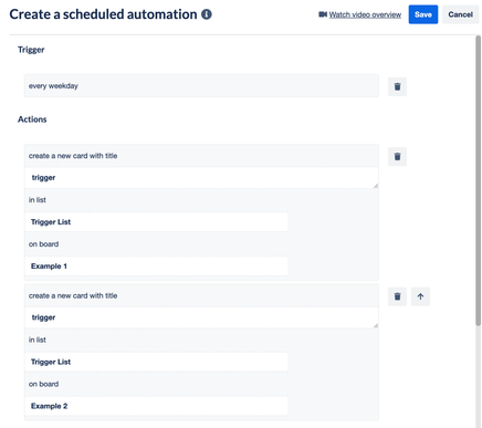

We don't have to stop triggers to automation. However, as a workaround, you can create a main automation to control another automation.
IE:
Create a Scheduled automation that will create a card named "Trigger" in all the boards you need to automate:
Every weekday, a card named "trigger" will be created on the boards "Example 1" and "Example 2."

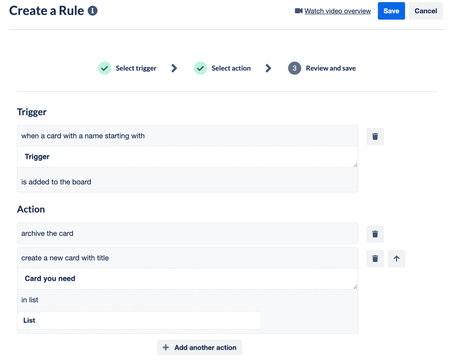

Then, for each board, create a rule that will trigger with this card:
When a card named "trigger" is added to this board, archive it and create a new card named "Card you Need" in the list.
It requires effort to create the automation; however, to stop all the others, you'll need to turn off only the scheduled automation.
