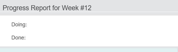

My end goal is to be able to receive an automatic report in my email inbox of all cards from a list (Meeting To-Do Items).
What am I doing wrong?
every monday at 9:00 am, create a report in variable "Doing" with all cards in list "Meeting To-Do Items" using pattern "- [{cardname}]({cardlink}) ({cardmemberusernames}) {{%Priority}} => DUE on {cardduedate}", create a report in variable "Done" with all cards in list "Done!" using pattern "- [{cardname}]({cardlink}) ({cardmemberusernames}) {{%Priority}} => DONE on {{%Completion Date}}", and send an email notification to "(my email)" with subject "Progress Report for Week #{weeknumber}" and message "Doing:\n\n{$Doing}\n\nDone:\n\n{$Done}"
Currently, it looks like this when I receive it:

@Kristina B The command looks correct, if you're certain you haven't got any typos in the list names, what I would recommend is testing each part manually. So create a board button that creates a report for just one list with a simpler card pattern and instead of emailing it, create a new card with the report variable in the description.
If that works, try making the pattern more complicated, adding 2 variables, and so on, adding things one by one until you find what breaks.
Here's a silly question -- does the variable have to match anything on the list? Currently, the two list names I'm trying to get a report on are 'Meeting To-Do Items' and 'Done!'.
I put 'Doing' and 'Done' as variables in the command so they show up in a easy to read format through email. Could that possibly be throwing it off?
Thank you so much for your time!
Update:
I was able to get the report to come through but the priority levels are not showing up in the emailed report. It's not pressing so I am going to just roll with it.
Thanks again for your feedback!
