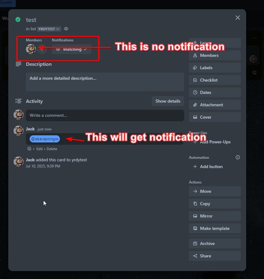

with Slack Powers-ups, I cannot get Slack notification in Mention Alerts section.
When I add and remove person from card, nothing happen in my Trello app in Slack.

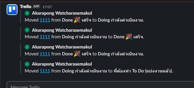

However, when I move card between list, Board notification is working fine.

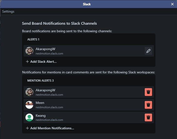

Basicly, I want to report bugs that
Board notifications are being sent to the following channels: is working normally
but
Notifications for mentions in card comments are sent for the following Slack workspaces:
is not working
Anybody has same issue, or know how to fix, please share with me.

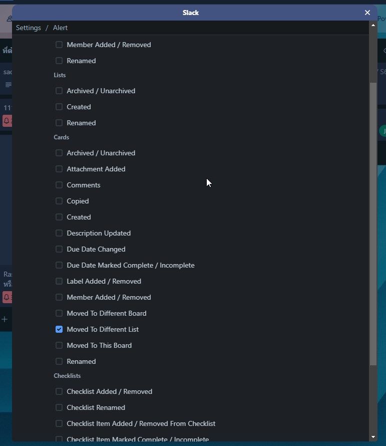

Thanks for the screenshots. To receive other slack notifications from the board, you will need to select which one you want to be alerted.
For that, you can go to the Slack settings on the Slack Power-up on your board (the same one from your first screenshot), and an Alert, and check the ones you want. I see from your screenshot that only "Move to a different list" is selected. You'll need to select all those you want to be notified about.

I have done all of those steps and got notification already.
However, from "Mention Aleart" We will only got notification in slack only when somebody tag us in Trello comment section. If I assign task to somebody in my team. I need to tag them in comment section as well to notify in slack.

Thanks for the additional information. I was testing here, and it's possible to get a Slack alert when someone is added as a member to a card.
For that, you will need to create a Slack alert and select "Member added/removed" under Cards options.

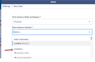

Another thing that I noticed from your screenshot is that it seems that you create an alert and select Direct Message for yourself to be notified (the second screenshot from your main message). Could you double-check and make sure to create an alert for the Slack channel you need?

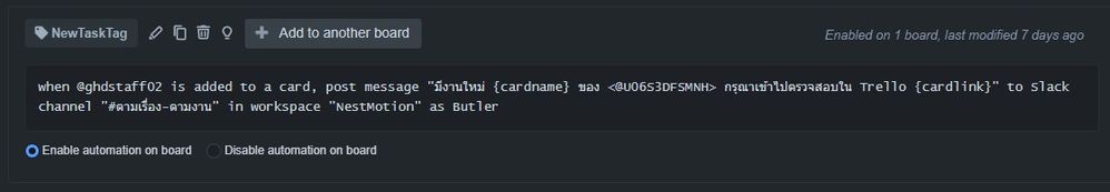

Mark on member added/removed will notify when anybody added/removed from the card. We want to get notify only when my name is added/removed from the card.
I have checked Slacked channel is correct. I got notify normally when people tag me in card comment. But will not get notify when they add me to the card.
My solution is add automation rule for each member of  the team.

Oh, I see! You want to be notified just when you are added to the card. I'm afraid there isn't an option to get a notification just for a specific member right now. The Power-up will notify everyone, as you see. Your solution was great, and it will ensure that only you get the notification.

Only moved card action show up in slack.
