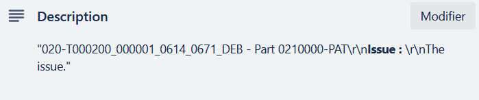

This is the query:
https://api.trello.com/1/cards?idList=XXXXXX&name="7 - test test"&desc="020-T000200_000001_0614_0671_DEB - Part 0210000-PAT\r\n**Issue : **\r\nThe issue"&key...
And the card description:
vbNewLine and vbCrLf give the same result:

Dag Atle Stenstad
January 18, 2024
Ah, you pass the variables as parameters in the URL. You can try using %0A for a line break since it's in the URL (similar to how spaces are replaced with %20).
Dag Atle Stenstad
January 18, 2024
You don't need to parse to JSON when you send it in the URL. That's only necessary if you're sending it as a JSON object (which is recommended).

I didn't know we can call with JSON Payload !
Thanks, it works fine.
I didn't need to convert the name and the description of the card before sending it:
