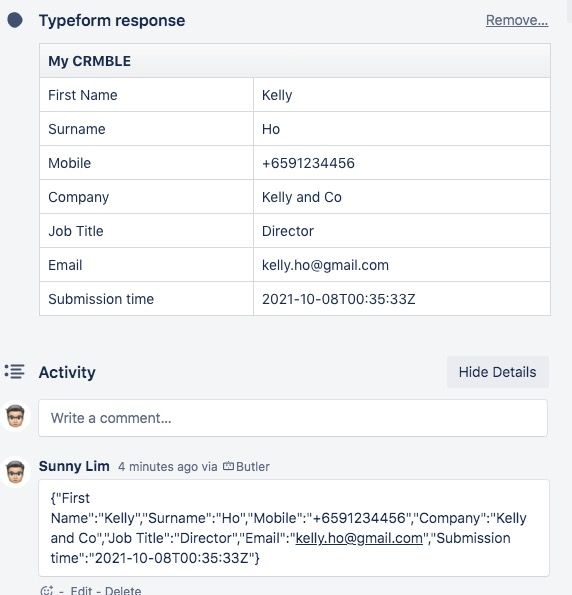

milynnus
October 7, 2021
@Owen Meyer
If you have the means to distinguish between the forms, you can simply move them to different lists.
This is the same concept I used for a client using Native Forms where each form type will trigger a Move upon receipt so that it will send RFQ to different suppliers share with them partial details of the customer request.
It is made easier because the form data is deposited in the description field whilst Typeform is embedded in an attachment (last I used it because I need to get into the attachment to get a piece of data I need for automation)
Update : code still works

milynnus
October 8, 2021
@Owen Meyer
In the case of my client the category is selected by the client on the form and that is used to move the card the list by the same name as the category.
