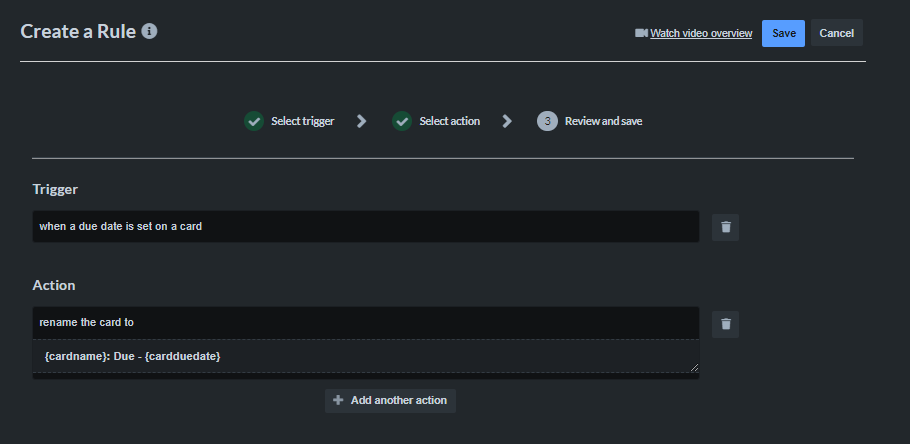

You will find the variables all here:
https://support.atlassian.com/trello/docs/butler-variables/
An example is here...
