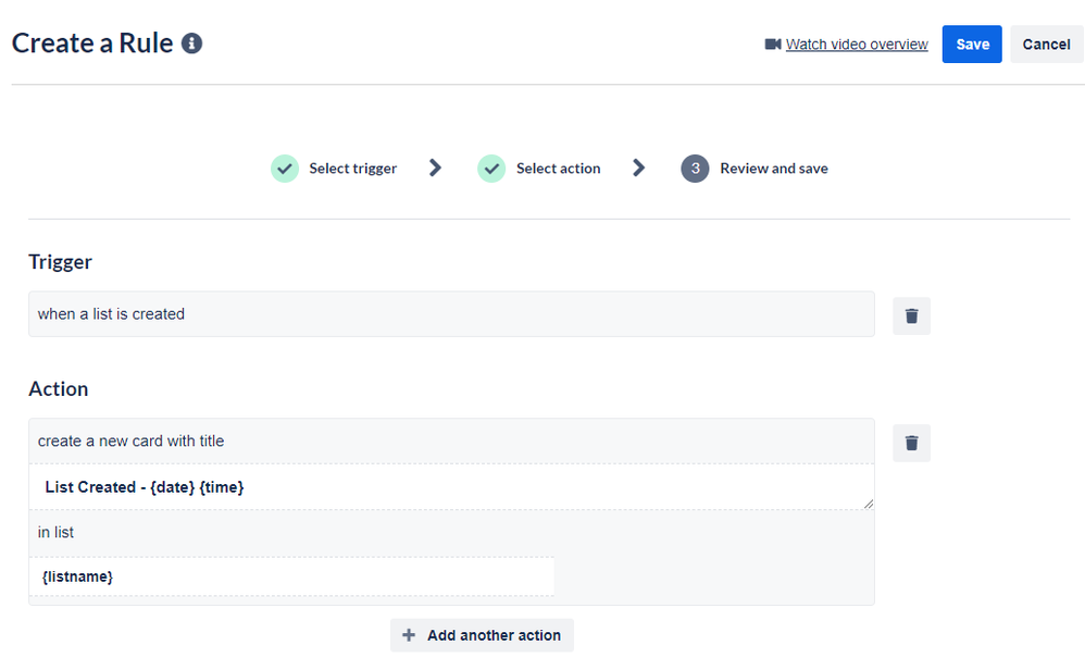

Mike - Dreamsuite Consulting
November 23, 2023
Hi @LUIZA GAYER
Retrospectively checking existing lists will require a bit of work as @Rasmus Wulff Jensen suggests but there is a simple automation you can add to track new lists...
