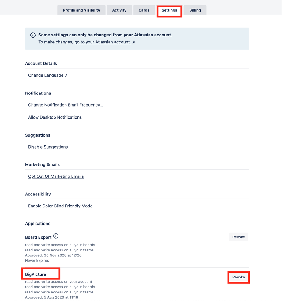

Hello,
BigPicture may influence Due Date fields, even if the power-up is disabled. To solve the issue, please go to Trello Setting and click "Revoke" in BigPicture section. See my image as a reference. Best,
Anna
SoftwarePlant
Thanks ! that helped me so much

@Caroline Tamayo I had the same problem. BP power-up was disabled/removed, but the problem persisted.
Turns out there is an additional section which grants permissions (which Anna has referenced, above). You need to click on your profile picture, then "Settings", then under "Applications" you'll find a list of power-ups which have access to your boards...revoke BP's permissions here.
