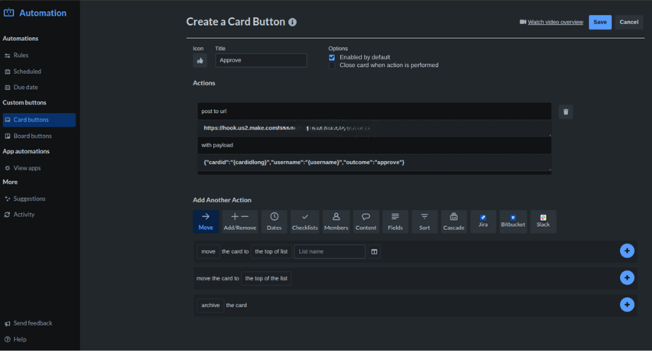

Top tip, you can use Trello automation to Trigger a webhook. I use this A LOT when I am building solutions for people with Trello.

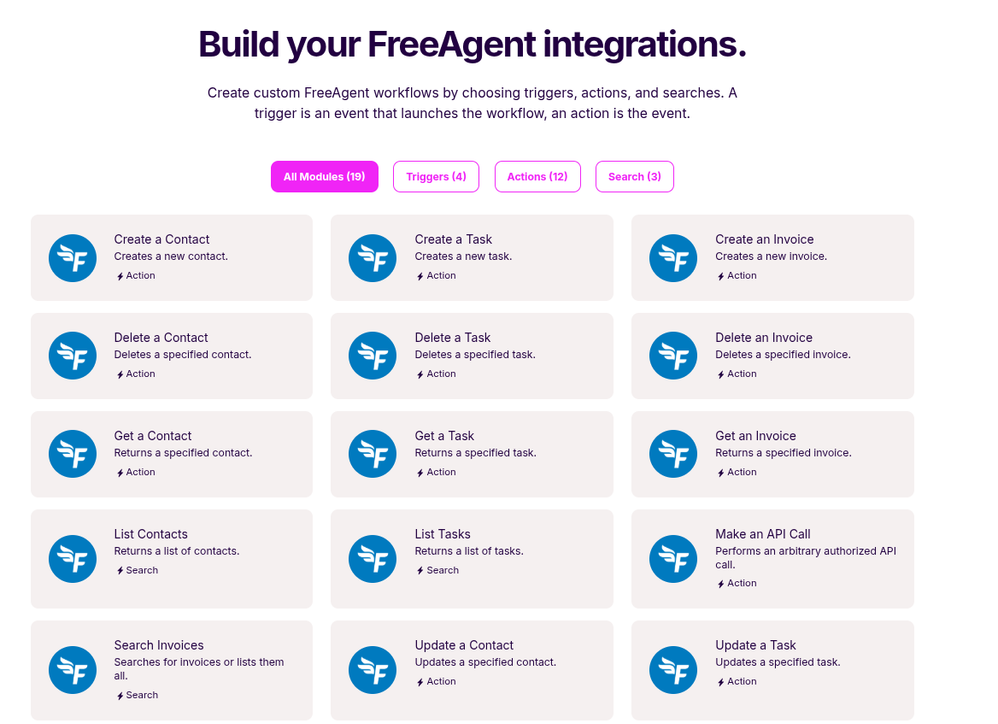

@Mike - Dreamsuite Consulting I see your London based - (I'm down in Brighton FWIW) - just our of interest - do you happen to know if Freeagent has potential for integrating with make? That might be a useful avenue to explore. I'm not a coder as such, but do have a technical background (in game dev), so not averse to simple scripting and picking my way through APIs/Proprietary systems.

A quick look and Freeagent has a very comprehensive set of Make modules:
I think that it would be really cool to integrate FreeAgent and Trello and will certainly allow you to remove a number of your Trello manual and automated steps.
