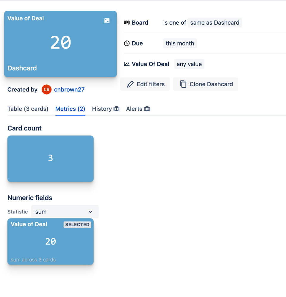

One tip since it took me a few minutes to figure out...
If you want the Dashcard to display the numeric sum of your custom field (bdft/board footage) instead of the card count, you have to:
- Open the Dashcard
- Scroll down and select "Explore and Edit"
- Then go to the Metrics tab and select the numerics field.Screen Shot 2022-02-17 at 2.12.58 PM.png
