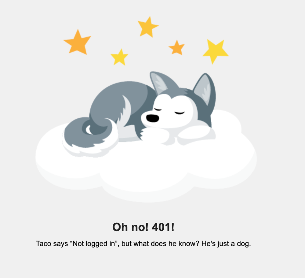

@Felix I'm trying to implement OAuth 1.0 and it says that I can access my API key by logging into Trello and visiting https://trello.com/app-key/. However, even though I am logged in, the url returns a 401 error. How can I access my API Key? Screenshot 2022-10-25 at 10.36.17 AM.png
