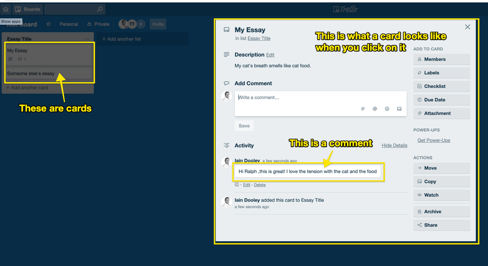

@Ian Campbell I think we may have some terminology problems. Just to clarify, these are the interface elements I'm referring to:

When I said the students post their replies on individual cards on the List, I should have said they post their replies on an 'Add comment' on the essay card.
So the List is called 'Writing Topics', and in the list are a number of different writing topics/essay titles. One topic on one card is chosen, and then students type their essays into a 'Comment' box, and type their feedback on others' essays into the 'Reply' box.

@Ian Campbell I think a better way to structure this would be:
1 list per topic
1 card per student
Students post their feedback on each others' cards
