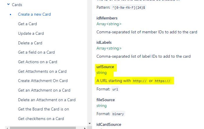

Those are the parameter to give when creating the card. So this doesn't actually return the url of the card created!
So no, it doesn't answer my questions
