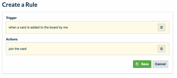

I also use a Butler rule (this isn't the one I use), but this will do the same thing for every card you create on the board/move onto the board/copy onto the board, it'll automatically join you regardless of any due dates (joining a card automatically subscribes you to it), it'll blanket add you to every card. Trello have a helpful site on what notifications you'll get when you add a member to a card. Hope this helps:

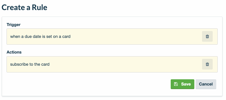

@Jonathan This Butler rule will subscribe to every card on which you add a due date:
