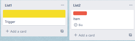

I'll try to explain it a little more in-depth, so I've made a test case:
I have two cards, as shown above: Trigger and Item.
"Item" is a one-time input, this is the product. It's either bio or not, so this is checked only once and that's permanent.
"Trigger" is the customer order, so each time a customer places an order, the employee creates a new card.
Then, the product (Item) gets linked to the customer order (Trigger), this is done by adding "Item" to a checklist in card "Trigger". It links the cards.
The moment "Item" is added to a checklist in card "Trigger", I want it to check if "Item" has custom field "Bio" checked, yes/no. And I want it to copy this value to "Trigger".
Any other suggestions? I think perhaps the triggercardidlong/foundcardidlong aren't correct, though I'm unsure because I truly have no experience in this.
