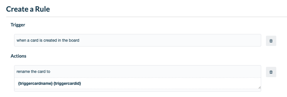

@Claire_Ashton there's no automated job number, but every card has a short ID which you can access via a Butler variable, for example:
this isn't a particularly memorable job number, but you could always just refer to it using the first or last 3 digits, for example if the card id comes out as "95g2iwrH" you could just call that job 95g.
