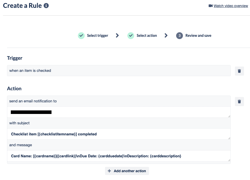

Hi Corvin, welcome to the Community!
If you are referring to a checklist item, you can create an Automation Rule instead of an email report using a combination of automation variables, and using card variables to get the card name, card link, card due date and card description:2023-10-27_16-31-47.png
Here it is in text form but you can change to the pattern that you prefer:
with subject
Checklist item [{checklistitemname}] completed
and message
Card Name: [{cardname}]({cardlink})\nDue Date: {cardduedate}\nDescription: {carddescription}

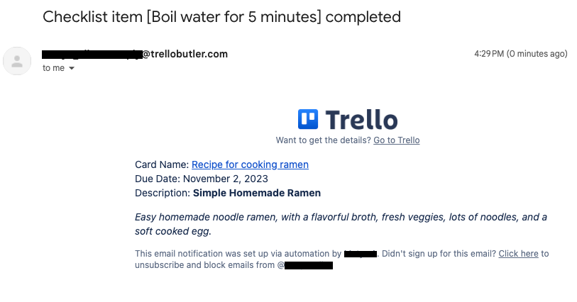

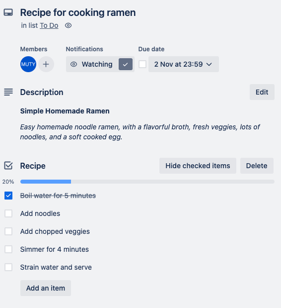

Using this card with a checklist as an example, and with the automation setup above. If I go ahead and check the checklist item "Boil water for 5 minutes":
Here is what the recipient will receive in the email:
