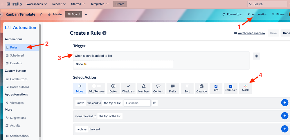

You can create a scheduled automation such that an email will be sent when a specific condition is met (Note: scheduled automation is not realtime, so the email might be sent at the end of that day) OR you could create a trigger such that a Slack message will be sent when a specific condition is met (screenshot below). Details here https://trello.com/guide/automate-anything
