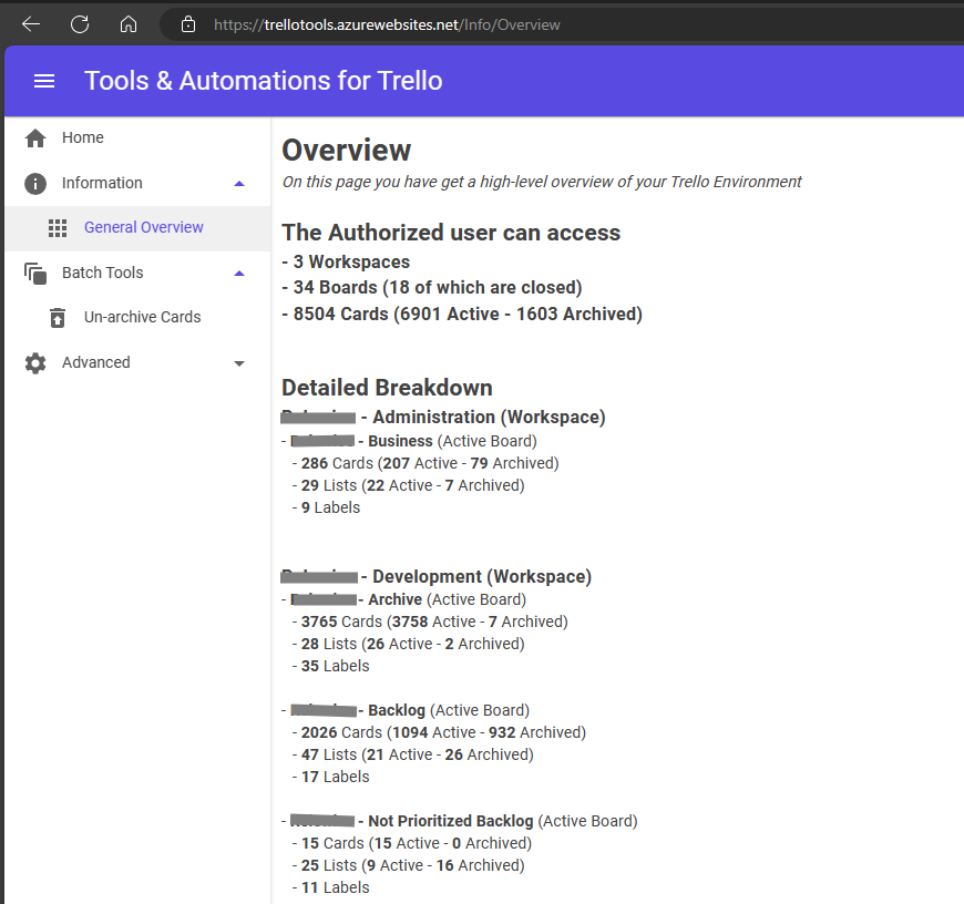

Rasmus Wulff Jensen
April 23, 2024
If still relevant, then this tool can do it: https://trellotools.azurewebsites.net/Overview (it will take a bit of time collecting all the data live (below screenshot took ~35 sec to generate))
