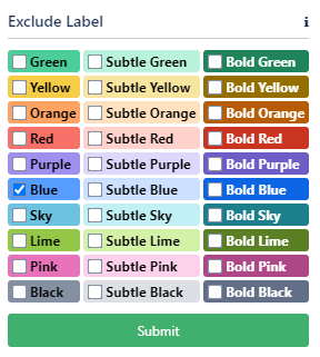

Saijo
July 1, 2024
You can use this bookmarklet https://saijogeorge.com/trello-filter-exclude-label/
